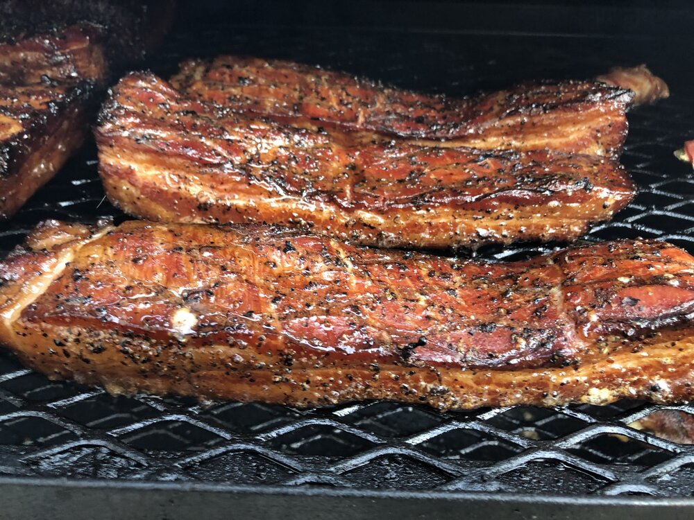

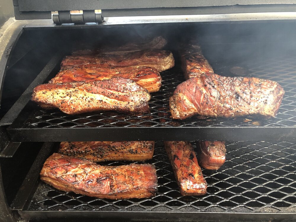

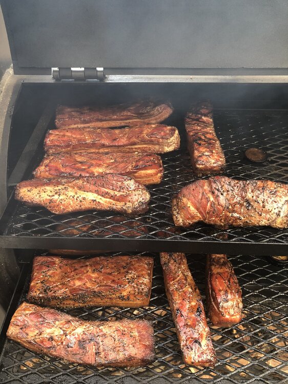

I've done it a couple times.  Here was the last batch.
After a week in the fridge with cure, salt, brown sugar. black and red pepper
On the smoker.

Forgot to post the recipe.
2 tsp Pink Curing Salt (Prague Powder #1)
½ cup brown sugar
½ cup honey (I used maple syrup instead)
¼ cup red pepper flakes
¼ cup smoked paprika
MIx all ingredients together thoroughly. Spread and rub into pork belly. Place in bags and remove all air. Cure 7 to 10 days, turning daily. On last day rinse off rub and pat dry, coat with black pepper and place uncovered in the fridge 24 hours so it can form a pellicle.  Smoke 3 ½ hours or so, internal temp should reach 150.
