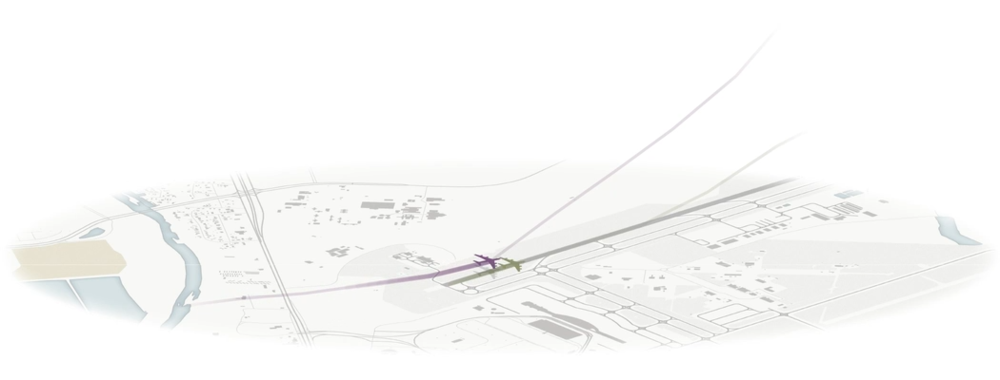

February 11, 20232 yr On 2/6/2023 at 8:45 PM, Homercles said: Dude made a visualization (in severe-clear) based off available data. Damn close.
