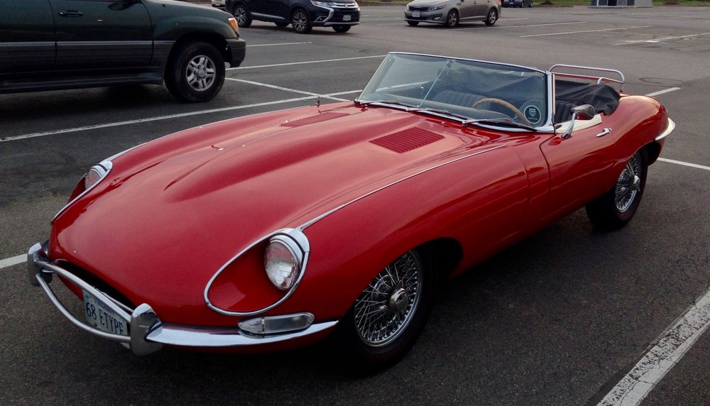

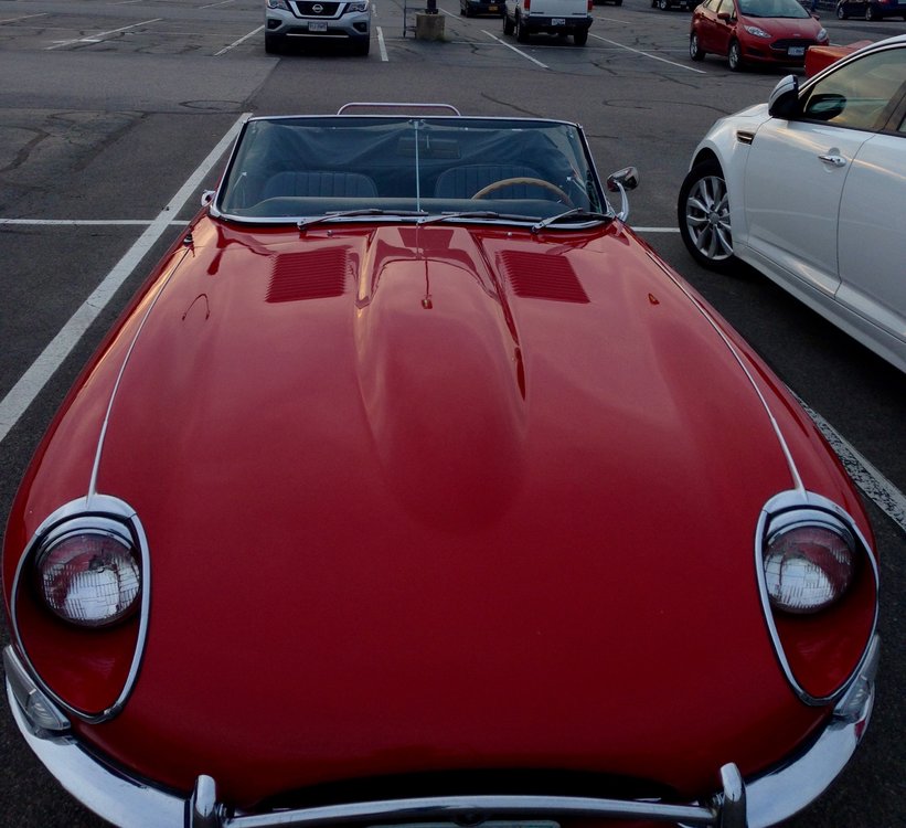

Saw this 68 E Type at Lowes yesterday. Always had a very soft spot in my heart for these, even if the Prince of Darkness is always your co pilot.
Something to me that is just so much sexier in Euro class....like yea your Camero is cute, but we have 19 generations of lordship and Princess Diana sat in this jag. I love my American classics, but they’re nothing to classic European sex.

Just one element of the E-type has always bothered me, and it's on display in the above pix:  the wheel wells/arches are too big for the wheels/tires.
Nice.  This is the classic car thread equivalent of "ugly knees, would not bang."

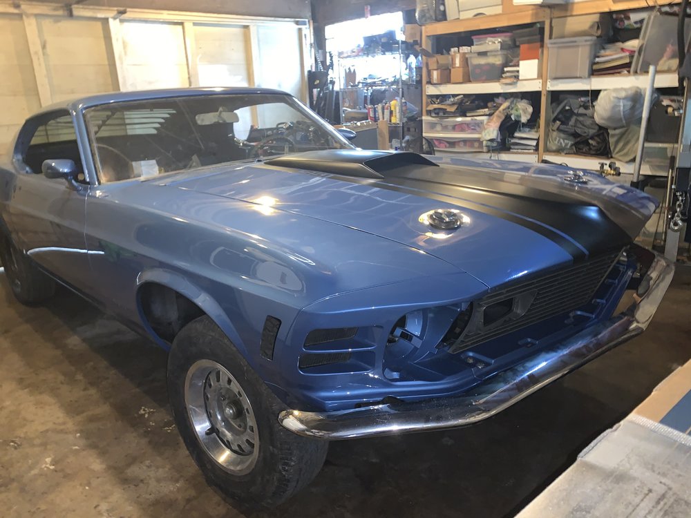

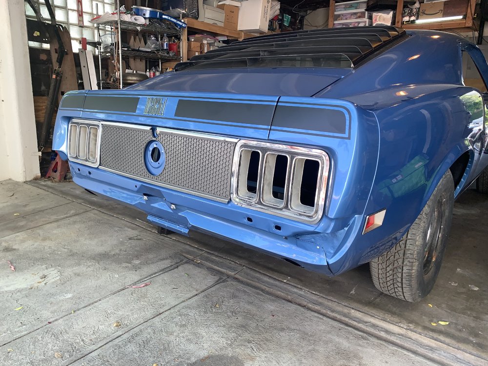

Well hello there, welcome home.   Did the paint shop treat you well?  Yes I see they did.
IMG_5844.thumb.jpg.ef377152ab8666437534c0932ec8989a.jpgIMG_5848.thumb.jpg.444a6f89d35db79cc2ca53744b511dd2.jpg

Looking very good. Can you give us a run down of the process from start to finish.  I think you posted some pics of a guy sandblasting it prior to painting.  Interested in what the whole process looked like.  What kind of rust abatment was done (is the cowl area fucked on teh 70s too?)?  Did you have the underbody detailed?
Looks great.  Gonna be a fun project putting that back together.

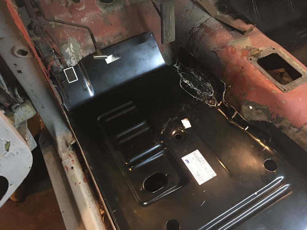

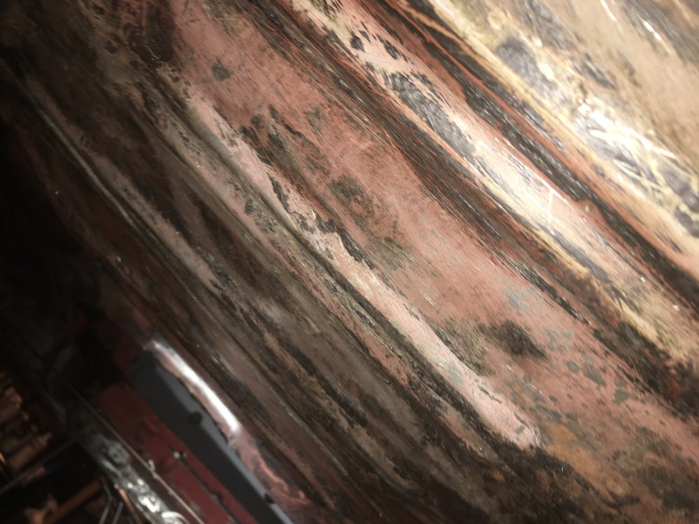

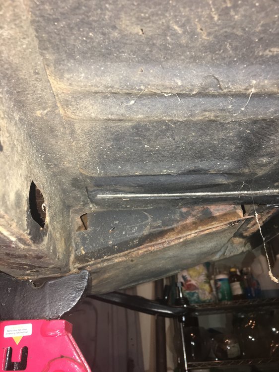

When I bought the car it had a shitty layer of primer on it, so I used magnets to try and gauge how much filler was on the car.  Turns out I was lucky, very little.  Only cancer was on the rear wheel well, so when it was blasted there weren't any surprises.
I was also lucky in that there was so much tar/grease/much built up under the car, it acted as a protective shield.  I got underneath and manually cleaned all the old shit off and found the original red oxide primer on most of the undercarriage.  Afterward sprayed on the 3M protective coating.
The cowl had some pinhole leaks on the driver's side, which must have gotten underneath the carpet and trashed the driver's side floorpan (PO did some Frankenstein patching).  I decided against replacing the cowl.  One, that work would have been brain damage and likely beyond my abilities.  And 2, it still seemed structurally sound. So I hit it the pinholes with rust evaporator, filled them in with JB Weld or something similar, and then coated upside and underside with POR 15.
I took a welding class and replaced the DS floorpan myself.  Sealed all the seams and used the 3M coating to finish it off.
I talked to 3 or 4 body shops. Some guys wanted to replace EVERY panel regardless of the shape it was in - probably to make the job easier.  I went with a guy that reused all the original pieces and fixed rusty patches here and there.
