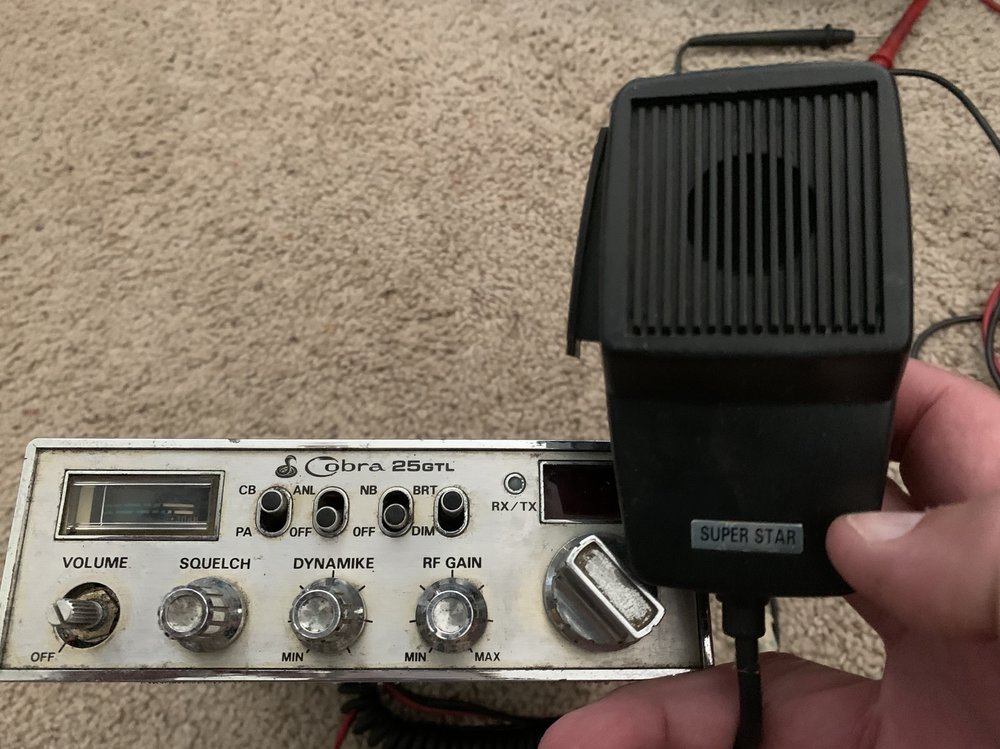

@Assman sent me a gift. I might have to wire it in my mustang

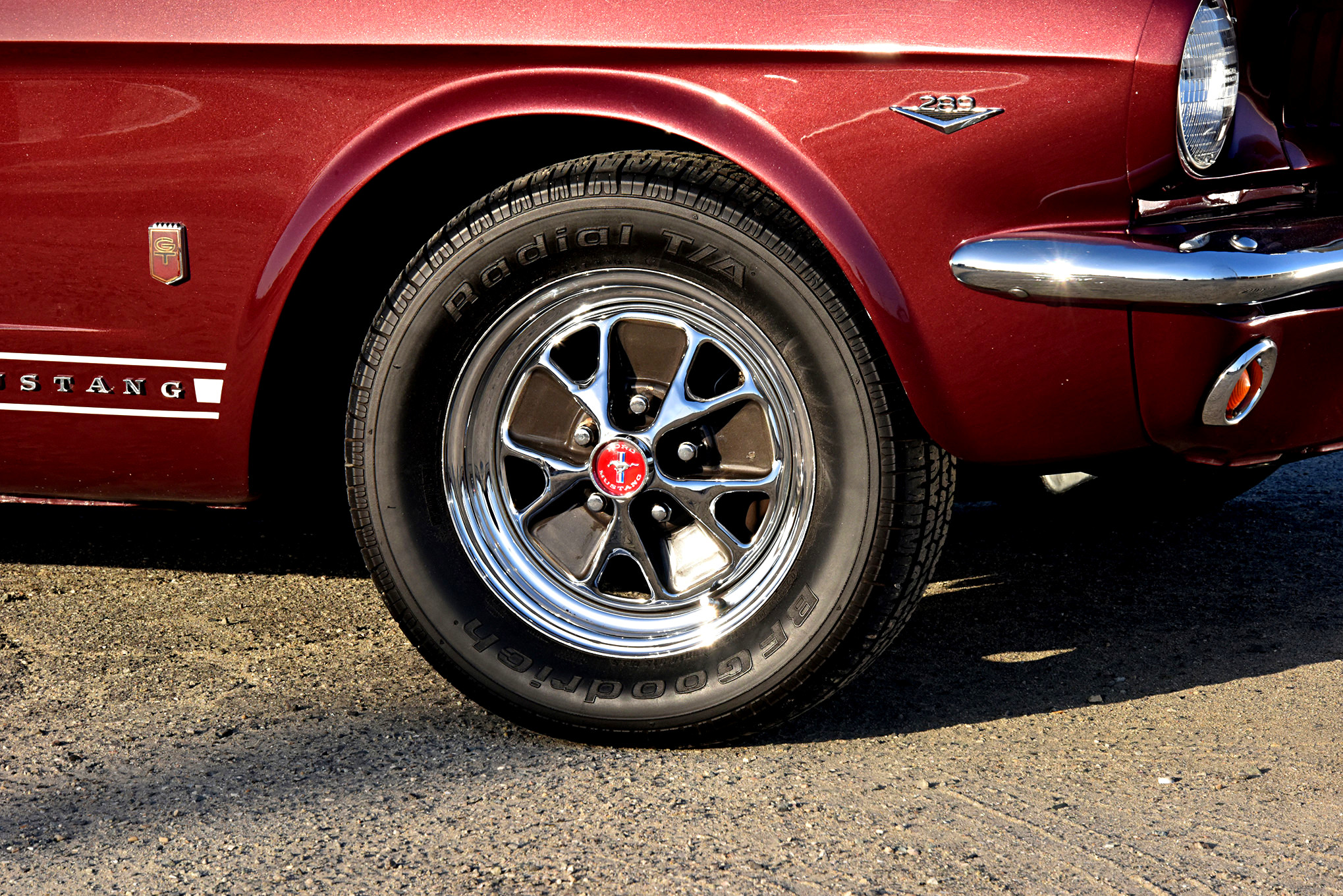

My high school son has a 65 mustang with the original hubcaps. Any suggestions on an appropriate wheel for this car?  I’m dying to put some bad ass wheels on it, just not sure what would be a natural fit. Any Surly help?
I like the looks of these as well, believe they are 10 spoke 67-68 shelby wheels.
Edited by Anastasis
The upgrades available then were the Styled Steel Wheels
Coker Tire 65SS156 - Coker 1965-67 Ford Styled Wheel Series
but a few others would look period correct like the Magnum 500s (what I have and a friend has them on his 65 too)
Scott Drake D1ZZ-1007-C - Scott Drake Magnum 500 Wheels
and Shelby 10 Spoke.
Original 67-68 Shelby Style 10 Spoke Alloy Rim
That said, wheels are a personal preference.
These are also correct for that year...
129777643.jpg?width=620&
I have the 1968 version of the styles wheels on mine...
Styled steel, magnum, or Cragars
I’m partial to cragars.
Those are cool! I actually looked at a couple of these online last night. I’m pretty sure his is a 4 lug and not a 5 lug wheel. I was told you can tell a 6 cylinder from an 8 by the number of lugs, his is definitely a 6 cylinder.  Which brings up another hit to the stang fund. I’m thinking it would be smart to replace the existing brakes with disc all around, if I’m doing that, I will want to replace the rotors too, which will be 5 lug.
FUCK YEA!  The 74 beetle I talked about earlier was outfitted with one of these.  My best friend Paul would be on the PA constantly yelling shit at people.

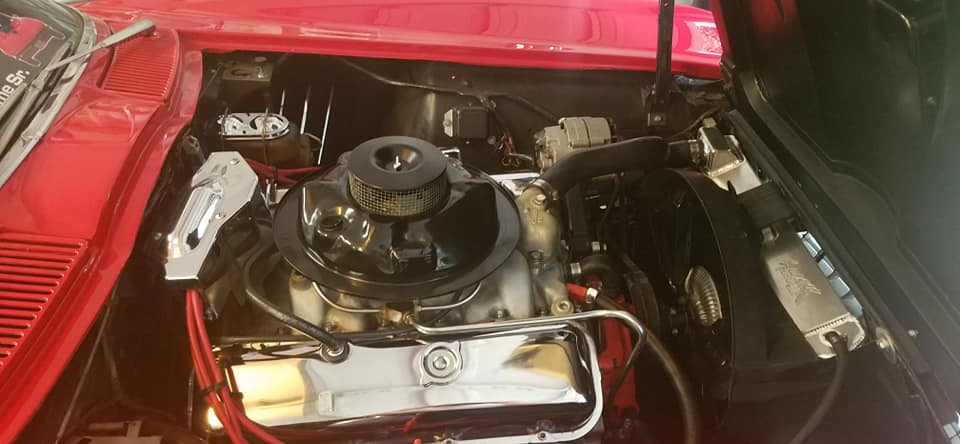

My buddy with the (2) '67 Fastbacks (+ a shitload more) is in the Daytona area; was gonna see about a referral but you're up in the FloriBama.
Here's his '67 Vette, L88.  523 hp, weighs 3,007 lbs. empty.

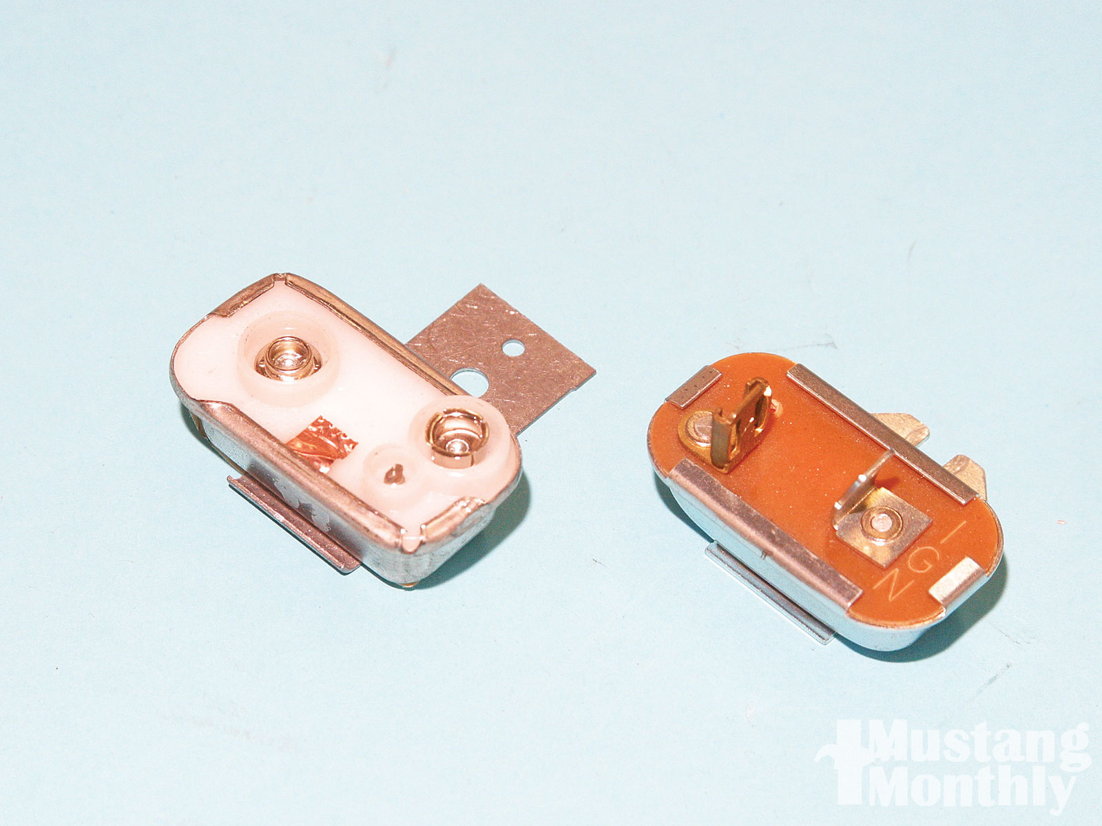

Some electrical gremlins.  Hopefully you guys can help me diagnose. Battery is dying. Replaced with new battery.  Still walking up to a dead battery after a couple days in the garage. Getting 12.4V at the battery 14.5V ish with teh engine idling.  I believe that this indicates that both my alternator and voltage regulator are functioning fine. So I got a short somewhere bleeding me out?  My fuel gauge was also acting goofy, so maybe something in that circuit.  At the moment just going to pull the positive terminal off the battery until I have a better diagnostic plan. Fuck electronics are the thing that I hate to fuck with.
Get a multimeter and take a fuse out one at a time, watch for the drop.  That could help at least regionally localize the drain problem.
Sorry man, electrical issues are indeed a bitch.
So drove over to the advance auto parts and had them test the alternator just to confirm.  Everything checked out.  Disconnected the negative terminal on the battery with the car off and tested the draw, got 0.27 amp which based on the internet is about 0.22 too high. So something is parasitic draining it. Haven't fucked with the fuses yet because the ford engineers put the fuse box in the most fucked up place possible.
At same time, am still having issues with the fuel gauge pegging past full. The temperature gauge is fine, so that would seem to rule out the instrument panel voltage regulator. I am seeing the fuel gauge pegged intermittently past full even with the key out and everything off.  I believe that the pegged gauge means that there the line to the sending unit is grounding somewhere, and I am wondering if it was wired up to somehow to be charged when the car is off, and the short might be causing the drain. Did I mention fuck electronics.

@Anastasis I would try the voltage regulator(s) first. Since both act the same it is something common to them (Voltage regulators, circuit board, etc).
Before you tear anything apart take the wire off the fuel sender and the temperature sender separately and together and see if you still get readings on the gauge with nothing connected.
There are two inline VRs that could be the problem.  There is the one in the engine bay on the passenger inner fender well (or onboard an aftermarket alternator).  The original style mechanical ones go bad.  You can get a solid state replacement and may be able to use the old cover to disguise it.
images?q=tbn%3AANd9GcS3sTTRx6IR0PNLkPjMlPQ_j8LiIM4SvUgkfaV_uzqMiyXrJHQv8g7rjgkr6-tgMFwrLxfJF_4&usqp=CAc
There is another one on the back of the dash.
28806181.jpg?width=210&height=140
