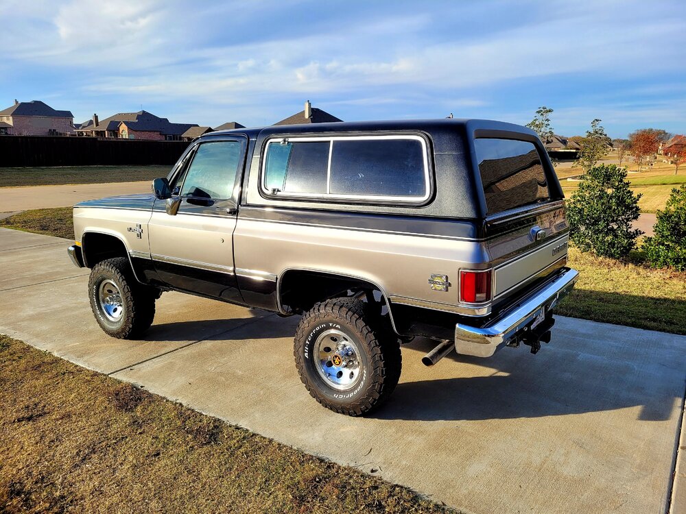

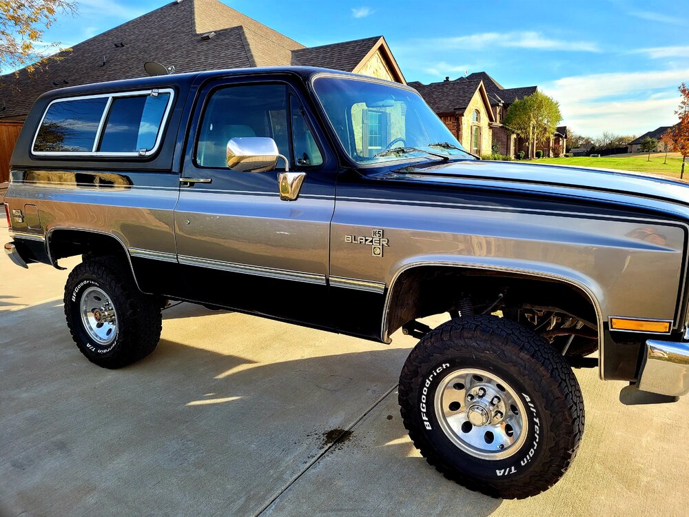

For reference, it cost $9,300 to completely paint my K5 with very minimal rust repair.  This included installation of new weatherstripping and seals on the entire truck, along with a new windshield.
#2804
Which I don't think I've even posted pics of since it's come out of paint.  Now that we moved to a new house with a taller garage since these pics were taken, I'm going to go a little bigger on tires to close that gap.  Also note the puddle of coolant there showing the exact moment my heater core decided to shit the bed.  That was a fun project.
Yeah you can get a good paint job for less than $10K on a 60's Mustang, especially a convertible.  The Blazer looks good BTW !

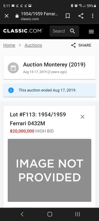

On 1/15/2022 at 5:11 PM, Prepuce of Doom said:
Hard to find more information besides this, but there was a high bid of $20m in 2019 - not sure if that means or did or didn't sell though.
Do y'all not see the price tag of $35,000,000?
Had a girlfriend in college with a K5 and it’s one of my favorites. Good lookin Blazer!
#2808

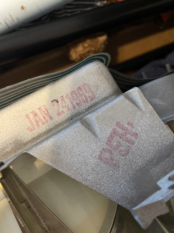

I jump into the VIN discussion from August :)
I'm not an authority on this but everything I have read and my own experience is that classic mustangs did not have the VIN stamped on the engine blocks.  VIN location was/is on the driver side fender apron or inner fender and then there were copies in the dash and on the door tag.  The VIN included an engine code letter to tell you which engine was equipped from the factory.  The block had date codes stamped or cast into various parts so you could look at the block, intake, carb tag, manifolds, etc and see the correct part numbers and date codes for the parts on your car.  Old mustangs are all about the combination of correct part numbers and date codes.  I have most of the original equipment from my car that was built in Jan 1969 and the date codes are mostly from Dec 1968.
Picture of date stamp on my dash cluster that is sitting in my office.
Edited by TexasEd

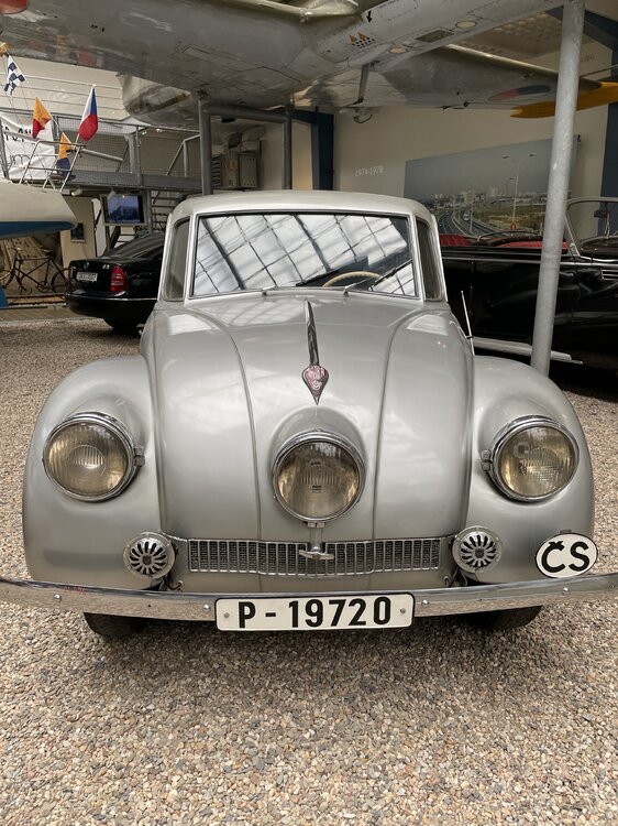

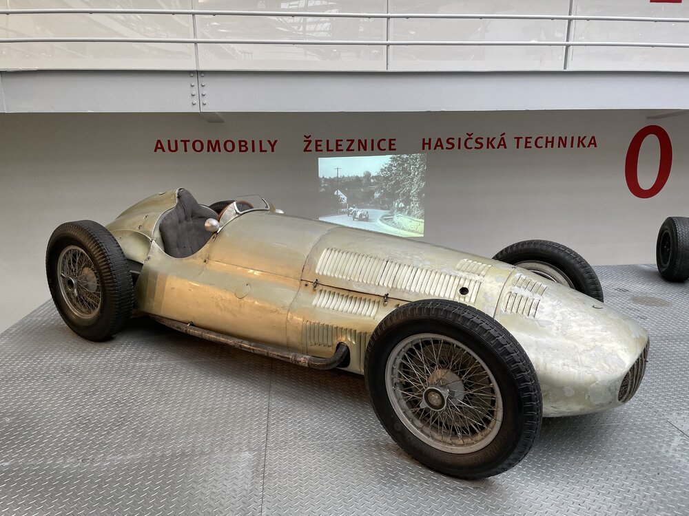

I paid a visit to the Czech National Technical Museum.  The whole place is worth a visit but here’s a few of the best pieces on display.
This Tatra 77a was produced in the mid to late 1930s and was the world’s first aerodynamic car to be produced at any scale. As with a lot of Czech stuff, there is some weirdness. A tiny 3.4 liter air cooled V8 is parked out back.  It was not big on power but the slippery nature of the car meant it could cruise at over 90 mph- extremely fast for pre-war. Inside, it was a luxury automobile.  Hitler himself was a fan and declared it the “car for his roads.” After occupation, Nazi officers preferred the car to their own German makes.  All that weight behind the rear axle and high speeds on pre-war tires mean snap oversteer.  The car gained a reputation as a “Nazi-killer.” Ferdinand Porsche “borrowed” a lot of ideas from Tatra with this make and others to build his Volkswagen and after the war had to pay a judgment.
This was the car’s successor, the Tatra 87a.  Powered by a 2.9 liter air cooled V8, it got up to over 100 mph in the immediate postwar era.  It was among the fastest cars of its time.  The build quality on these was incredible.  Two beloved Czech adventurers, Zikmund and Hanzelka, drove one of these across some of the worst roads in the world on a driving tour of Africa and Latin America.  The two of them learned that the Communists took over in a coup while out on their journey. They came back and were allowed to publish (wildly popular) books but eventually bumped up against Commie power and became dissidents.
Maybe one of the most valuable things in the collection, which includes a Supermarine Spitfire.  A 1938 W154 Mercedes Benz Grand Prix car.  This is the make that won the 1939 European championship, when the Auto Union and Mercedes “Silver Arrows” dominated all challengers.  This one is in near original condition and ran a V12 with well over 400 horsepower.

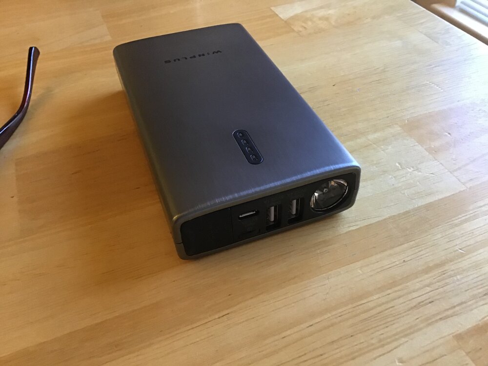

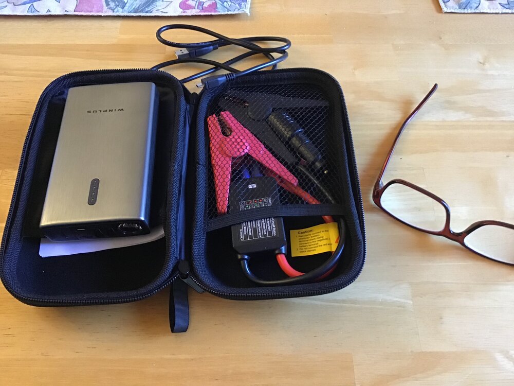

52 minutes ago, TexasEd said:
What do you all recommend for a battery booster/jumper to keep in your car?  I’ve looked but there are a bunch of sketchy ones out there.
Got this neat little battery booster kit at Costco for $50 several years ago.
In fact bought several for everyone in the immediate family to keep in their cars.
It will jump start a firetruck with ease.
How do I know that?
My brother’s grandson is a firefighter, and did just that to jumpstart their biggest ladder firetruck at his Austin fire station.
Also good for using witha lot of your electronic devices.
I use one similar to what @Armybrat posted, but made by Cobra (CB radio guys). I would have never in a million years thought something that size would work, but buddy saved me with one once. They don’t work on fully drawn down batts though.
#2843
What about batteries that have been mostly dead all day?
#2844
The times I’ve had issues with it is when I roll down to the camp for the first time in 9 months and try to jump a truck.  It doesn’t do that well.   But on a batt that is dying on the reg and I’m trying to limp along for a bit more, they work great.   The fact they are the size of a large cell phone and can charge your phones/computers/etc as well is a bonus.  They charge on 120v or thru 12v, so one every 90 days or so I plug it into my 12v on the way to work and it’s ready to roll again.  Pretty cool tech for sub $50.  An actual jump box is what it takes for something that’s been long dead.
#2845
I have used my little jump box to help 4 other people out, but haven’t had to use it for myself, yet.
They are great for when you get stranded.
The NOCO ones are good but are also pricey. I have an Audew or some Chinese brand that reviewed well from some guy on YouTube.
