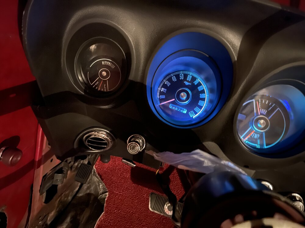

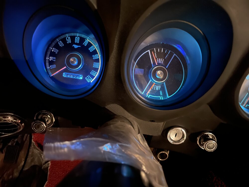

I bought the LED light bulb replacement and went with the coke bottle green. It's a nice upgrade, not game changing, but not difficult to do. Those old bulbs are not bright.
Vintage-mustang.com and allfordmustangs.com are 2 I've gone to from time to time.  There's a thread about LED instrument panel bulbs on the front page at vintage-mustang now.
Do you have a link to to part or a part number?

It was about 6 years ago.  I bought em thru CJ's pony parts.  They WERE a great parts supply place, but have been very spotty since COVID.  Did you check out the thread on the Mustang site I mentioned ?

I did thanks.  The guy I'm using is resistant to using anything but white lights, so I was trying to use an angle of someone I know having used a specific product.  I just told him to humor me and try the Mustang Project version.  It's only $30, plus whatever he marks it up.  We'll see what happens.

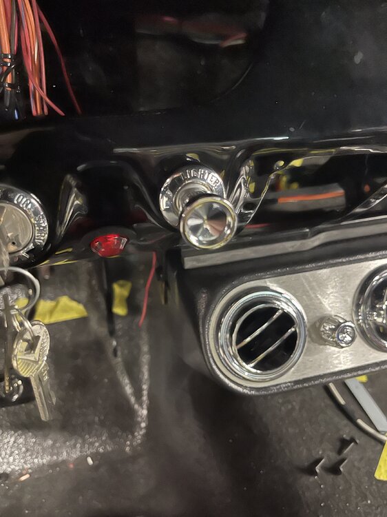

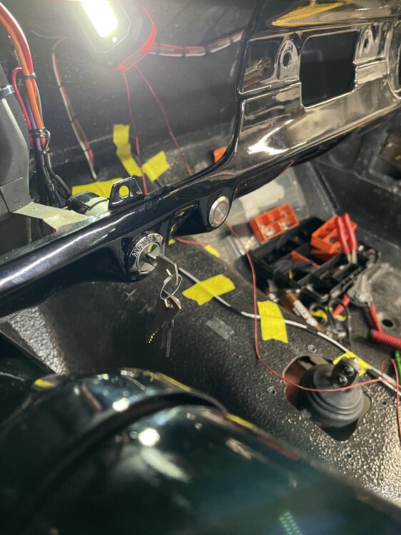

Current status of dash.  I put an electronic emergency break in.  The button for it is in the slot where the cigarette lighter used to go.  But I am not a fan of the look.  I'm trying to see if we can use the original cigarette lighter to be the push button for the break.
Now I need to upgrade the stereo without cutting up the dash.  I hate the sound of the Classic Sound, whatever they are that fit the dash.  I'm thinking about sticking the original back in the dash, then putting a modern head unit in the glove box and just running it by bluetooth from my phone.  I really don't want to mess up the vintage look of the dash with a new head unit.  But like I said, the modern head units that fit suck ass and I wanna rawk.
The green looks better than the white IMO.  Has a more vintage look for my money.
That's what I told him.  If it ain't coke bottle green emanating from the cluster, it ain't my car.
He's an older fellow and he is brilliant with old cars.  But the trade off is that he definitely veers off into, "Listen young buck, I know what I'm doing here" territory - which is fucking hilarious because I'm no longer some young buck.  I haven't had occasion to go all "OK Boomer" on him, but we're dancing around it.

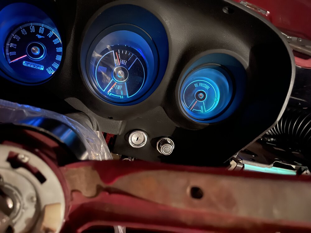

Both problems I’m addressing. I bought the blue-green lights from Mustang project but left my lenses in there so I will try and test them today and post it.

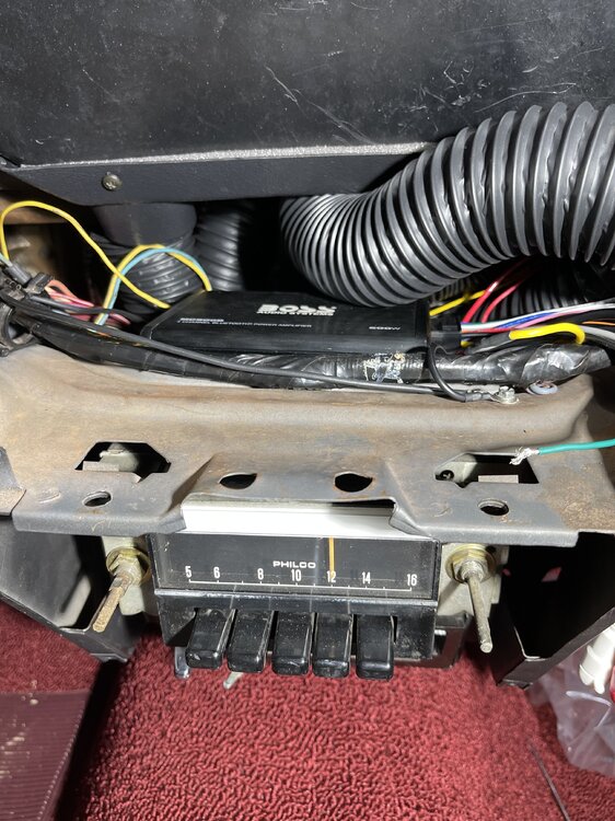

on the radio I installed the original AM radio and only hooked up the light. I have this Bluetooth receiver and Amp in it.

Exactly what I did.  Look at this post just a little above yours:
You can see the Amplifier looking box that says Boss on it is on the shelf above my factory radio and below the AC duct that I am installing.  It is pretty loud with the testing I have done.  No AM/FM receiver you can use a 3.5mm Aux cord, USB (phone charging), line in or Bluetooth to send the signal.  It also has pre-amp out if you want to drive separate amp or subwoofer.  I may run the wires for a sub to be added in the trunk at a later time.  It has a wired remote I will just hide in the glove box.  Everything can really be controlled by the phone once it connects.
Some custom touches I thought of but did not do:
  • Use the radio on/off knob to drive a relay to power it.  I just have it wired by relay to ignition
  • wire the radio speaker out into it to be able to select AM (might be worth it if you have AM/FM)

Lighter button now activates the emergency brake.  Little red jeweled light there is emergency brake engagement indicator.
