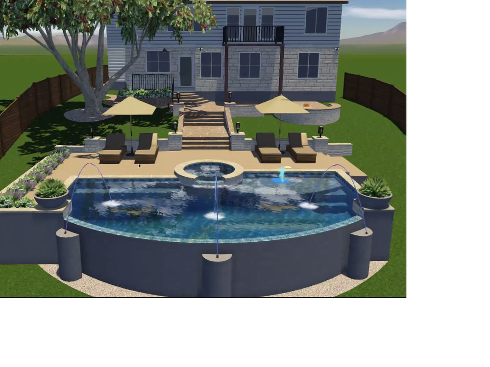

Having my first pool built (we had one when I was a teen that I maintained).
Specs are 34x14' about 13,500 gallons.  3.5' to 6' depth.  Priced with all Jandy equipment including the robotic cleaner, gas heater, and DE filter.
It will have a faux negative edge on the arc end.  I was initially nervous about water splash out but I guess it will be ok?
I saw up thread a lot of people mentioned getting the heat pump pool heater but is that a good plan with a spa?  About 1/3 of the cost is in the sidewalks and decking.  We have to push it out from the house to protect a heritage oak (represented by the white tree) close to the house.
Anything you guys would change?
If you have the infinity look where the water is at the edge of the pool, then it should be set up for the water to go over the edge and caught by a return system. You shouldn't have water just going over the edge of your pool and into your yard.
Looks good.  I don't think the heat pump will work well with a spa.  It is not a quick heater.  Our pool is a little bigger (about 19' X 40', 4.5' to 6' depth) and you are lucky to raise the temp 1 degree per hour.  Of course, you would be heating a much smaller area for the hot tub, but I just don't see it being capable of a hot tub experience unless you keep it running 24 hours a day.
This is my concern.  It is described as an infinity edge look but you keep the water line at the bottom of it so it does not overflow the edge unless cannonball and then only as much as you might see splash out with a traditional edge.  I plan to have a gravel bed at the base of the wall.
I would love to hear any experience with this type of edge.  The fact that it is not common gives me pause.
Edit:  We do back to a greenbelt and there are some nice trees and greenery there, It is a sloped yard as well but we are not very elevated there is a small canyon behind my metal fence.  Right now the view is partially blocked by the zipline fort but that will come down and the pool will be here long after the fort is gone.  So trying to take advantage of the view was part of the designer's goal.
Full infinity edge with catch basin and return probably adds $20K to the cost.  This edge or traditional coping are the same price.
The infinity edge with the catch basin will probably lower the temperature in your pool by several degrees which will be nice in the summer.
But another $20K makes it a no go.  We have the 3 deck jets, bubbler in the tanning ledge and a sheer waterfall on the deep end to help cool.  It's either this faux infinity edge that lets the wind blow in (prevailing winds come towards the house) or standard edge.  I'll go get a couple pictures of the yard.

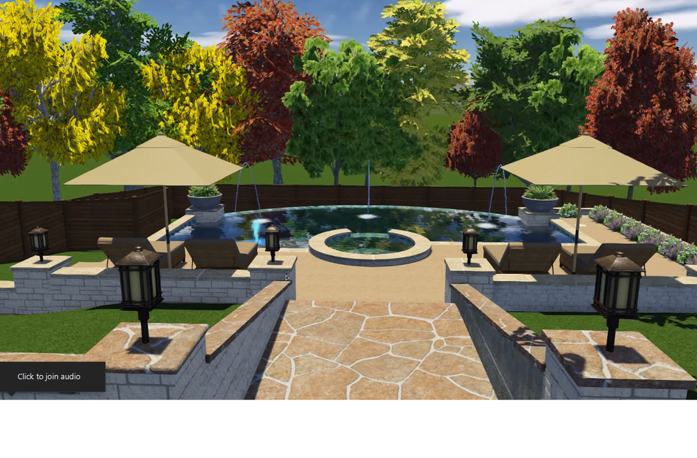

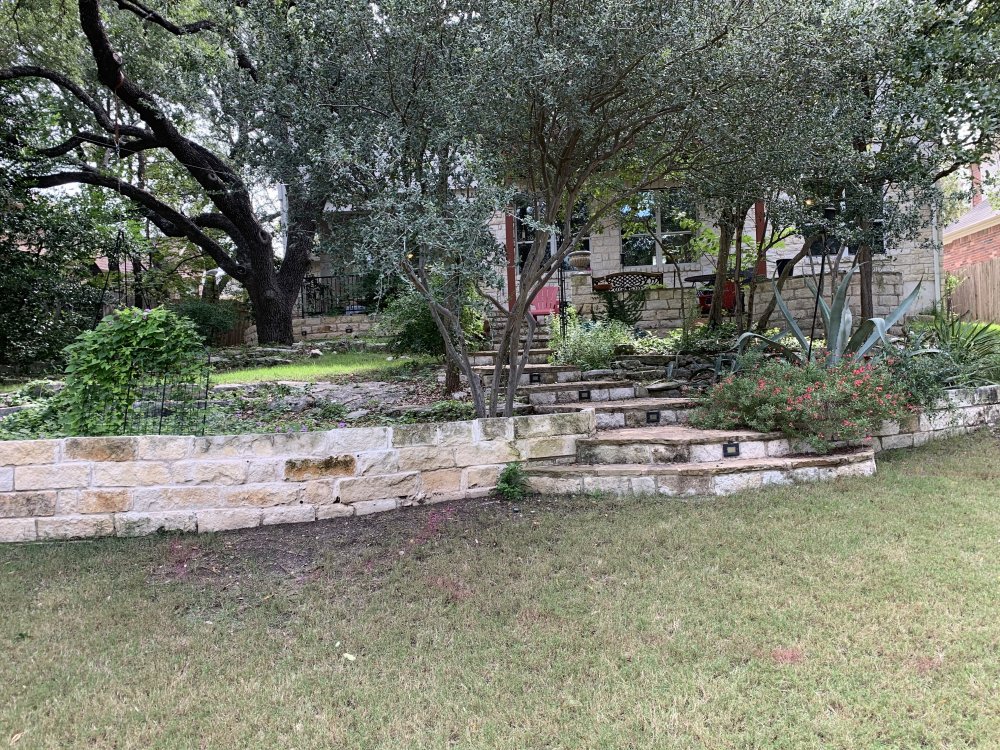

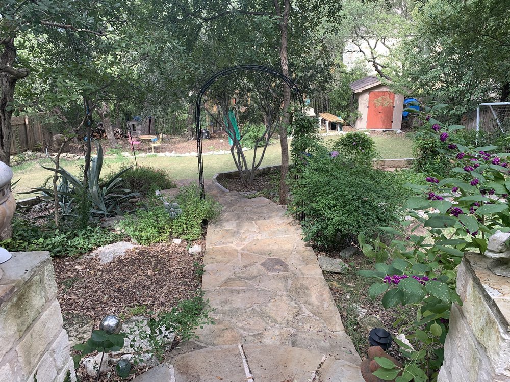

Here are some more pictures with current view and proposed.
Edit:  For reference, the metal arch is where the retaining wall for the pool deck starts and the existing retaining wall is where the water line starts.  Currently the back edge of the pool is about 3 feet from the rock border/end of the grass in the first picture.  Probably going to reduce the deck size to pull it close to the house.

20 minutes ago, TexasEd said:
low 6 figures.  Includes a long gas line run to the back of the yard.  Top patio area is already there but the sidewalk and steps down will be new/replaced and all the decking and retaining walls.  Light fixtures in the walls not included in price but the electrical work and installation is.  Our yard drops about 8 feet from the patio to where the back of the pool is.  Back wall may be as high as 6 feet above ground.  I'm working on getting that down and pulling it a little closer to the house.
I think prices are probably up 33% in the last 10 years when we last had a pool priced.
Jesus H. Christ.
Looks really nice though. I think the faux infinity edge or whatever looks a little cooler than just a normal edge there. I don't really understand the mechanics of water not splashing out of there a bunch. Only thing that kind of bugs me about the design is how the two sides edges closest to the house don't connect to the spa symmetrically. Maybe there's a design reason for that. I also think those little short walls sloping down along the sides of the steps seem a little pointless - feel like you're going to end up stepping over those all the time.
#762
View looking towards house.  The before picture angle is slightly above the water line.  Again, probably going to get that lowered some.
I've asked to fix the pool edge line twice and I think it got left out of the latest rendering.
The designer said the retaining walls on the side of the steps/path were to prevent the dirt from the upper areas washing down the steps.  I don't see it but my wife likes the look of it too.  The sidewalk is about 6 feet wide so I don't think we will be tripping over the wall.

Looks like it isn't a true or faux infinity edge then, so tell your builder to stop calling that. It's going to have water level below the edge and tiled edge.
It will give you an unobstructed view out the back which is nice.
#767
That makes sense. Really nice looking setup overall.
Looks like a pretty damn great start to me.  My 2 cents, since you asked...
  1. I think you already addressed this, but the lack of symmetry on either side of the spa seems weird if you're leaving it that way.  I'm guessing the right side (if you're looking at it from the back toward the house) is meant to be repeated on the other side?  So you have matching tanning ledges and water bubblers?
  2. Spa looks a little small for a pool that big to me.  How many people will that hold?  I'd consider making it bigger, even if you don't think you'll use it much.  Just from a proportion standpoint, it looks a little off.  Maybe even make it more of an oval/ellipse or rectangle so it takes up more room left to right and cuts into some of that suntan ledge (which is pretty worthless).
  3. My biggest change is the 3 pillars with the deck jets in the back.  Not sure what that's adding to the cost, but I'd scrap them.  The pillars, unless thy are needed for structural reasons, won't be seen from the house.  And although the deck jets are cool (I'm doing them on my pool now), you can absolutely accomplish the same look by having them come from the other direction.  That is to say, they can be in the deck and shoot away from the house and give you the same look and feel and that would have to be cheaper than building dedicated pillars for them and running plumbing back there.
  4. I think I understand that faux infinity edge and it makes sense to me.  The problem I have is it looks like they've drawn it like an infinity edge, but, assuming I'm understanding right, it's just a tile edge with no coping along that side, right?  That won't really look like an infinity edge.  I'd ask them to draw it how it's really going to look and see if you still like it.  And then I'd ask to see it with coping and see what you like better.
  5. Finally, be sure you have a place in the decking plan for dining furniture and conversation area furniture.  I'm guessing that will be up closer to the house, but it's hard to tell on the drawings.
1. My wife says It is supposed to be asymmetrical and I don't have a design eye.  the deep end had an additional jag in it I asked to be taken out so I "made it worse".  I want it straight across.
2. Spa is 7' in diameter interior dimension.  It is large but the pool is 34 feet wide.  My wife's # 1 feature is the suntan ledge.  When we go to a friend's house that is where all the women stay.  My want was the 6' depth that you can't stand in.  If you can stand in the whole thing its a wading pool not a swimming pool.
3. Again, I don't care about the deck jets in the back.  If they were free I would care less but at the price they are I guess I couldn't care less about them.  I got the step up on the deep end edge you can't see with a sheer waterfall.  That way it has a small diving platform if only an extra 6 inches higher than the rest of the deck.
4. There is a problem with the rendering that the faux edge does not come up to the same level as the tile surround and makes it look like a true edge.  We have seen it with coping and we chose this way.  as you pointed out the only thing missing on that side is the coping.  The tile goes to the same height all the way around it is just not drawn that way.  In real life it is supposed to be an optical illusion.
5. Yes, I have a huge existing 29'x13.5'  flagstone patio next to the house.  This is why I think we can shrink the decking around the pool to where we have room for 2 loungers and 2-3 regular patio chairs and a small table between them.  The retaining wall will also be seating height.
Edited by TexasEd
1. Like you, I would want it straight across too.  As I said, I'd want both sides to mirror the side on the right (as you're looking at it from the back side toward the house).  That would give her double tanning shelfs, since that's so important to her, and give you bubblers on both sides.  I guess I just don't see this pool as one that should be asymmetrical.  There's a fine line in design between something looking purposefully asymmetrical and something looking like a mistake.  But hey, she's your wife and happy wife...blah blah blah.
2. I'd consider a little bigger spa.  As @troph mentioned up thread, "It’s the most used feature across all seasons and all stages of life."  No truer words.
3. Not sure I'm following you here, but I think you're saying the cost of those pillars for the deck jets is negligible?  If that's the case, then yeah, leave them.
4. Yeah, I think you made the right call there...I think you're getting the next best thing to a true infinity edge.  Plus you can always just fill it up to the edge when people come over so they think you have a true infinity edge hahaha
5. Yep, sounds like you nailed it.

Getting ready to start on ours in the next week or so. Before picture from above attached, it should look a little different once complete. The people before got carried away with rock work and letting everything get overgrown.
