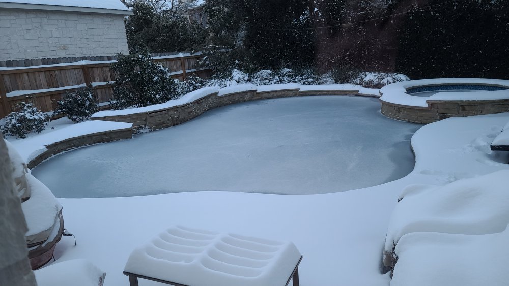

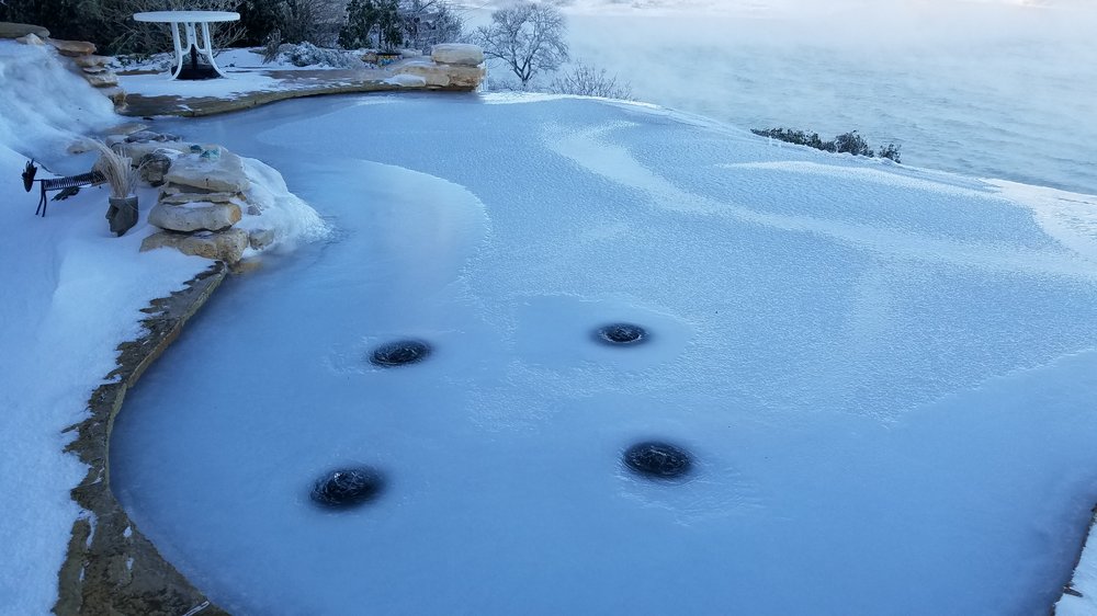

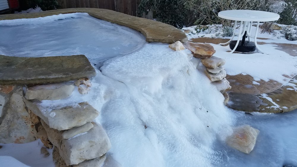

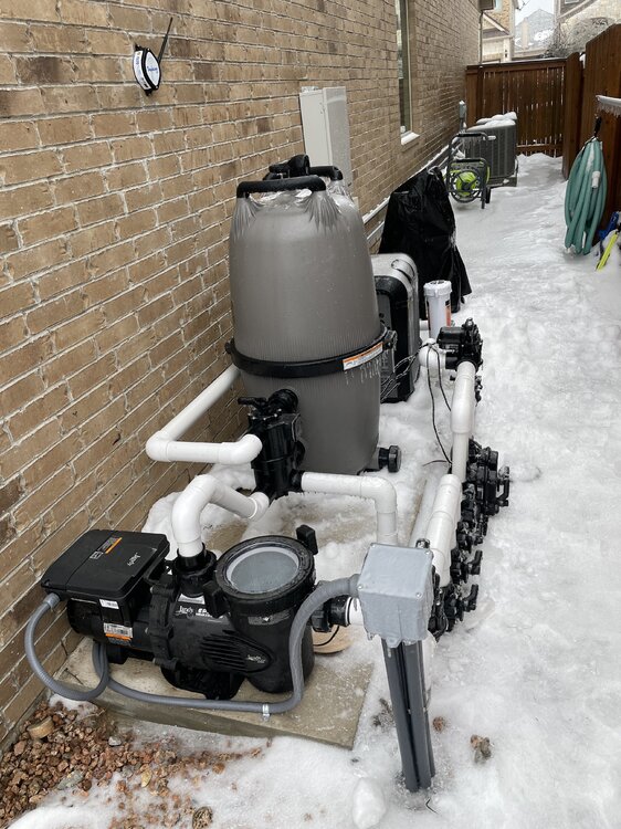

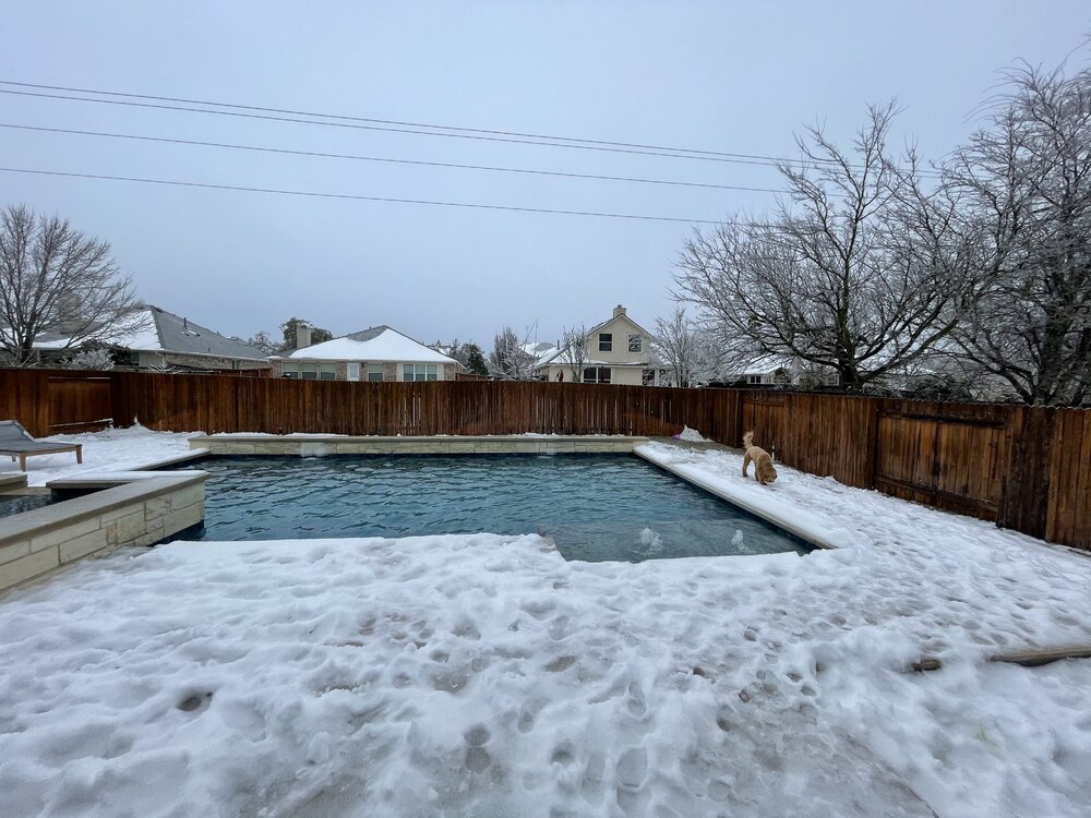

So my pool pumps continuously running.
Pump for water features froze up overnight. Guess im in waiting mode to see if it can thaw without busting anything. Damn. Could get costly
Not sure when it would start thawing.
March??
#1069
Now what the fuck do you do? Pump running full speed. Do you try to keep it broken or just let the top freeze over? 419e2b3304bca570f9ea760be463e52d.jpg
#1070
Sheeeit.
I suppose the goal is to keep circulation through the drains/returns, most of which are at least a few inches below the water surface.  Surely there's no way to get more than an inch of solid ice on top, at least overnight?  The biggest concern would be whether you'll still get return through your skimmers, though I don't know that there's much to do about that -- you could shut off the skimmer returns and hope they don't freeze, or leave them open and hope they don't just start pulling air into the system.
I dunno, man, this sucks.  Although I'll trade outdoor pipe damage for one bursting inside.
#1071
Update. Looks like we're rolling the dice here. Not on damage, but how much. Not sure how thick it is, but I would guess not that thick... YET310061d01c1dc4c58cc9c616be172570.jpg
#1074
This might be a stupid question, but at this point I'm assuming it's too late to drain?  We were fine until rolling blackouts started (had my equipment nicely tarped with a worklight keeping things warm as long), but power's been off an hour now.
#1075
As long as water flows your good.
Turn breaker off to all equipment.
Release pressure on filter.
Remove filter drain plug to drain water. At bottom of filter depending on type, likely need screwdriver or wrench to turn
Remove pump covers while draining, close after drained
Remove pump drain plugs to drain (usually finger turn plugs on side of pumps)
Heater also has drain plug you can open to drain any excess water.
Cover with tarp if have one after.
That's what I did to mine based on manuals winterizing just now.  No clue if best, just passing on. I did after read any freezing water in any of these voids warranty.
Edited by MonkeyDoughnut

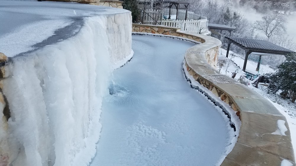

Here's my pool in Belton - both pumps have been running continuously and it still froze over.  Just praying the power stays on.  It's dark now and really windy and I don't want to try and drain the system during the night.

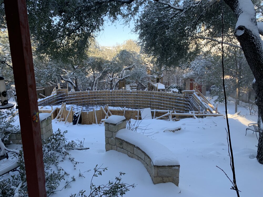

22 hours ago, Hefeweizen said:
We got so lucky with our pool.  It is older and was needing a face lift badly, so we hired Cody to redo it.  They had just finished chipping out down to gunite and we saw this coming, so we drained everything and they said they would come back when it’s back to warmer temps.  I think my pipes and pump wouldn’t have made it with this cold.
This is where mine’s at.  I guess the one silver lining to the mess our pool project has been.
Probably not the best time for a compliment but damn that’s a nice set up. Would like to see some photos when the weathers nice.
#1093
That’s an awesome pool/view!! Hope everything is well when it thaws.  I’ve had my equipment drained since Monday early am when we lost power... Hope that was enough to not do any pipe damage.

I knocked loose all the ice today in the pool and spa, yes, it started refreezing tonight.
Spa level dropped during freeze mode, so spa ice started taking small mousebite chunks out of my pebble finish.  Maybe a mistake on my part, but hard to say.  Will have to inspect it more when things fully thaw out.
Took off pump head and chlorinator caps yesterday and turned breakers off.  Will assess for damage on Sunday.
Didn't drain my backflow valve when we lost power (I was blind drunk and had other things on my mind), saw an icicle coming from the bottom of it today.  I'll take that apart as well after the thaw and see if there's any permanent damage.

I wish I had shut things down Sat or Sun and drained the pumps, but when I got up Monday morning and it was all frozen over, it was just too cold and windy to go out there and do it.  Hands were too cold in seconds.  Next time this kind of forecast comes up I'm winterizing.  Another 70 years?  Now I'm afraid to sleep in case the power goes out.  Pumps are still running right now, fingers crossed.

dirt falls still hanging in there in derkaville. i ended up breaking the ice buildup off the cascades along with whatever was on the pipes.
here’s how we look this morning
