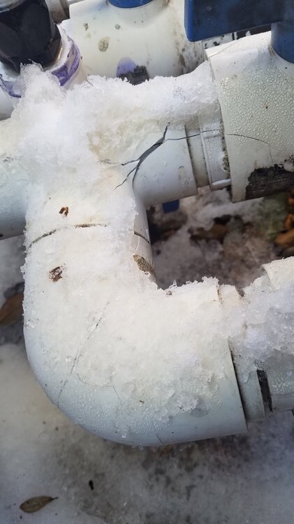

finally got a look today and it was as bad as expected...all we can really see is the pvc piping so far, and it's full of cracks. can only imagine what the pump innards look like. top to the basket unit was cracked as well.
at least it's only the pool equipment and it's self-contained. trying to stay positive!

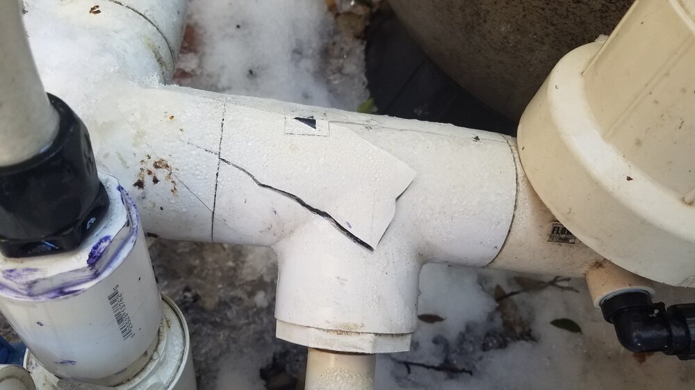

So I have that going for me which is nice. Cracks in the pump, filter, electric heat pump and two of the valves. I'm hoping the tiles made. The ice was still 3-4 inches thick in places this afternoon but beginning to crack up.

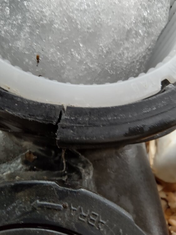

Lost power for 31 straight hours EARLY Monday morning to mid day Tuesday. I worked this thing over every couple hours through the whole week trying to keep ice broken up and not getting too thick (when it was -2 in DFW on Tuesday morning I was pretty discouraged by the battle) but ultimately kept it “flowing” and never thick ice.
I had pulled the plugs on the pump and took the lid off and released pressure on filter but was so tired forgot to pull plug on that. I had all the equipment covered from Saturday on. No cracks I can find in skimmers or any of pipes or other equipment and have obviously since opened filter drain. Decided to give it all day today and into tomorrow to really warm up and firing up tomorrow mid day.
Wish me luck and good luck to the rest of you working to get things back online.

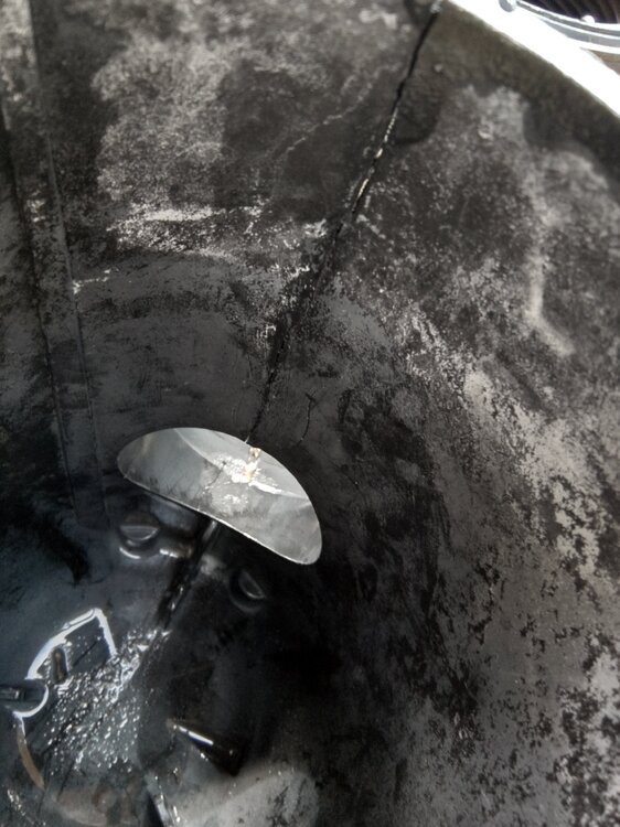

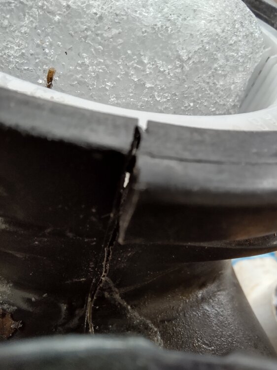

First pass at running the pump, discovered a crack in bottom of the uv bioshield vessel.  Ugh.  Guess I'll be buying some flex pipe tomorrow to bypass all that.

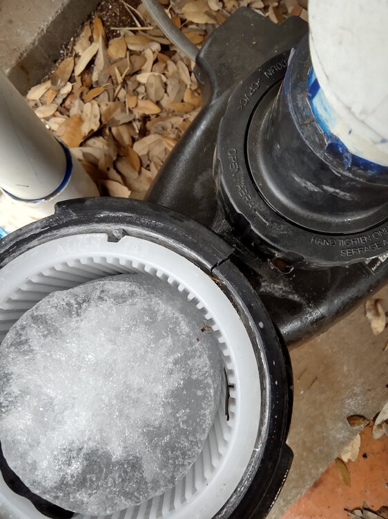

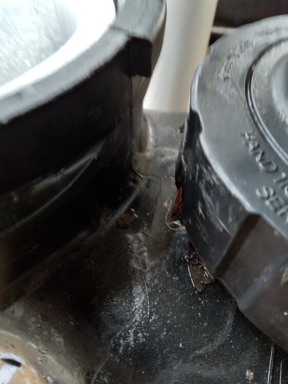

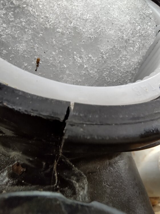

Now I have a cool filter shaped ice sculpture!
The ice cracked the top cleanly around the whole thing. Three check valves are toast. Booster pump cracked. I drained the main pump and water feature pump and they look ok. Lots of cracked PVC. Overall I have spent $450 on parts so far on things I KNOW are broke. Hopefully the heater isn’t screwed up.

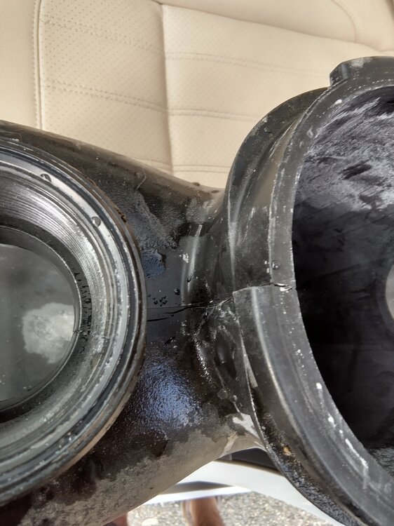

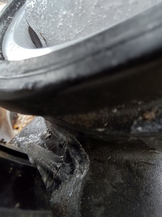

6 hours ago, immamac said:
Pump housing fucked. Everything else seems fine. Was trying to find a body shop to heat weld it for limp mode till new housing arrives. Anyone in Austin with a plastic heat welder hit me up.
IMG_20210221_081116.thumb.jpg.1dcf93e66a4c1e023fe69f270ea6283d.jpgIMG_20210221_081123.thumb.jpg.a708531ea8a753393529f8001ec71904.jpgIMG_20210221_081149.thumb.jpg.94b10d9403250f33b21bf751c17a19b1.jpgIMG_20210221_081158.thumb.jpg.07ff4f676406e56a7e88ea6309b44397.jpgIMG_20210221_081204.thumb.jpg.14a1c7cf48c5df62c2b35d05d12cc71b.jpgIMG_20210221_101454.thumb.jpg.bca4d13ce9934bbb552f8d3a88946d3f.jpgIMG_20210221_101504.thumb.jpg.7300d1d9f30c124c9fb203e8e28d5e1b.jpgIMG_20210221_101509.thumb.jpg.84519e786eaaf0e6670a46ac6f8ed5c4.jpg
Try JB Weld

Tied going the JB weld route on my heater manifold.... didn’t work. Started splitting back open as soon as I started torquing the 10 bolts that holds it on. Going to bypass my heater so I can run the pump until I can locate another manifold. Kicking myself in the ass for forgetting to drain it, plug is sticking right out in the open.

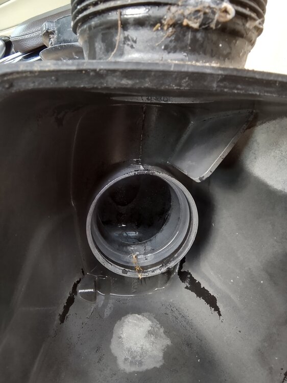

And a cracked manifold in the heater.
Home Depot pipe threads don't mate up with the union (always something...).  Found a pool repair guy who'll help me figure it out later in the week.
Replacement heater manifold is affordable, although looks like it'll be a bitch to swap out.  No option for just buying a new vessel for UV bioshield.  Looking at ~$1000 to eventually replace that....uuuugh.

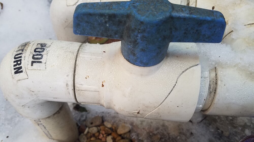

Just moved into a house with a pool. We never lost power but found a crack in a check valve that was seeping water until a program switched to spa mode and it started spraying everywhere. Repair guy can’t come until next week. How bad is it to keep the pool running until it’s fixed? Anything I can patch it with as a temp fix?
Also went ahead and ordered a replacement for fear they’d be selling out. Price had gone up 25% from yesterday. Let the gouging begin.

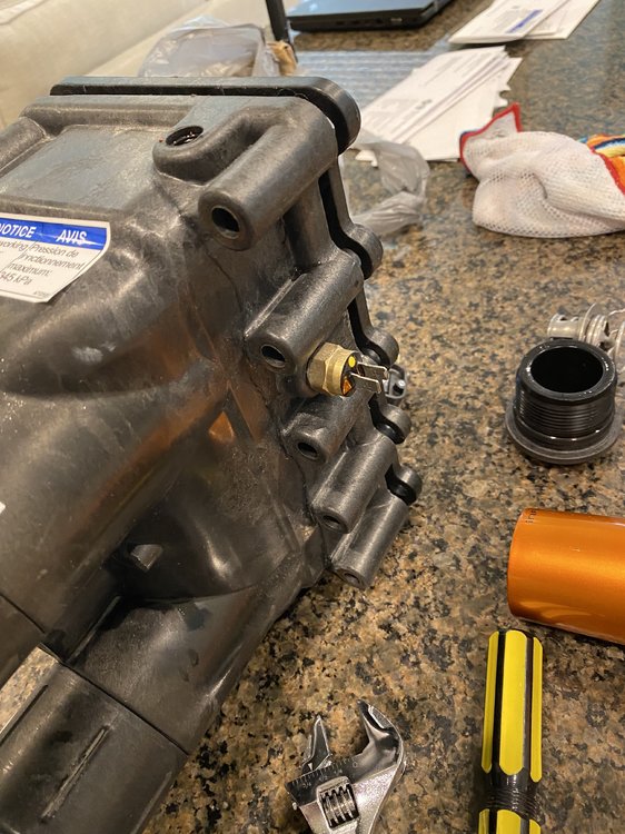

My insurance company is going to cover about 40% of the cost after deductible, so I got that going for me, which is nice.
My pool guy snagged (according to him, so who really knows) one of the two Pentair electric heat pumps his supplier had in the Austin area yesterday.  He's sending someone to New Braunfels to pick it up and I should have all of the equipment replaced and up and running by the end of the week.
