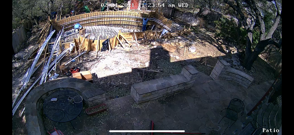

  • Here are some after pics for the project.  We started last September and have been swimming since Easter.  Pavilion/outdoor kitchen have recently been completed.  Sectional in the pavilion is incomple
  • Weather was a big slow down with the rain we had last year. Also removing an in-ground floor system I didn’t realize was installed was the other big delay...I don’t want my pool to look like it has 20
  • Before: pool built in the late 70’s. Major structural issues and ancient equipment that cost a fortune to repair over the years and maintain. Also had dated landscaping and flagstone After: wante

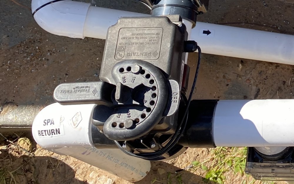

new issue, not sure how it could be weather related.
my return side actuator is only going in to spa mode in the aqua link app. when i switch to pool mode, only the suction side actuates. i have to loosen the lever and manually turn it back to pool mode. not sure why it’ll turn one direction but not the other. question now is do i bother trying to fix, or do i just get a new actuator before they’re sold out everywhere?
#1154
what kind you got, sound like a micro switch is bad on one side... pull and check ebay/amazon for replacement
Here is a Pentair one being replaced/tested to give you an idea of how simple it is (assuming that is the issue)

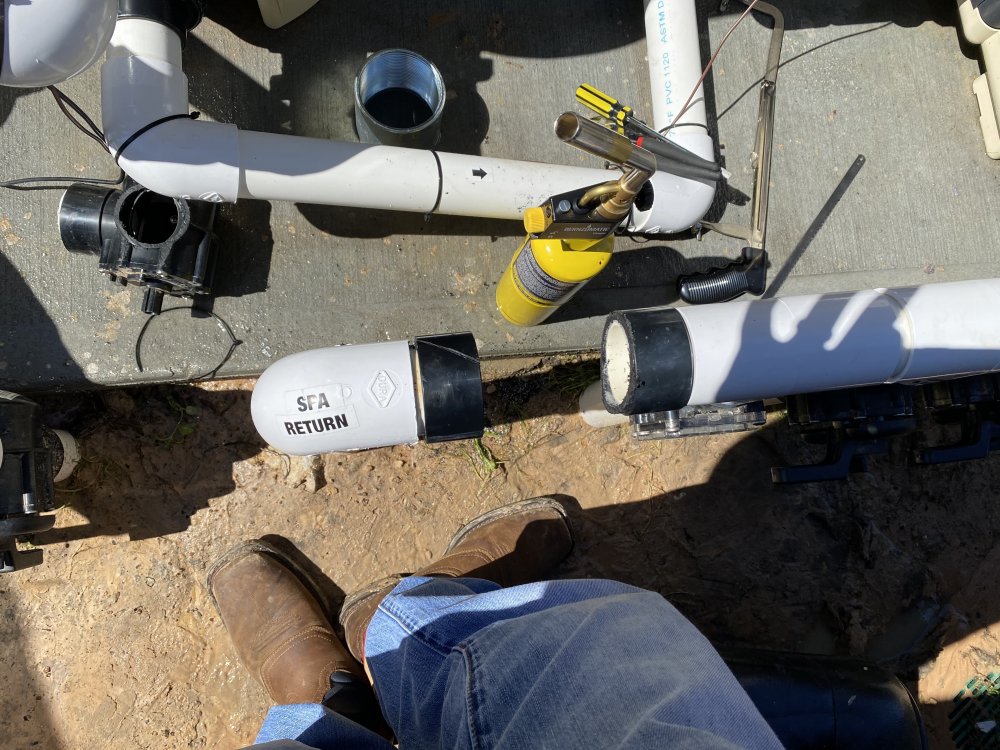

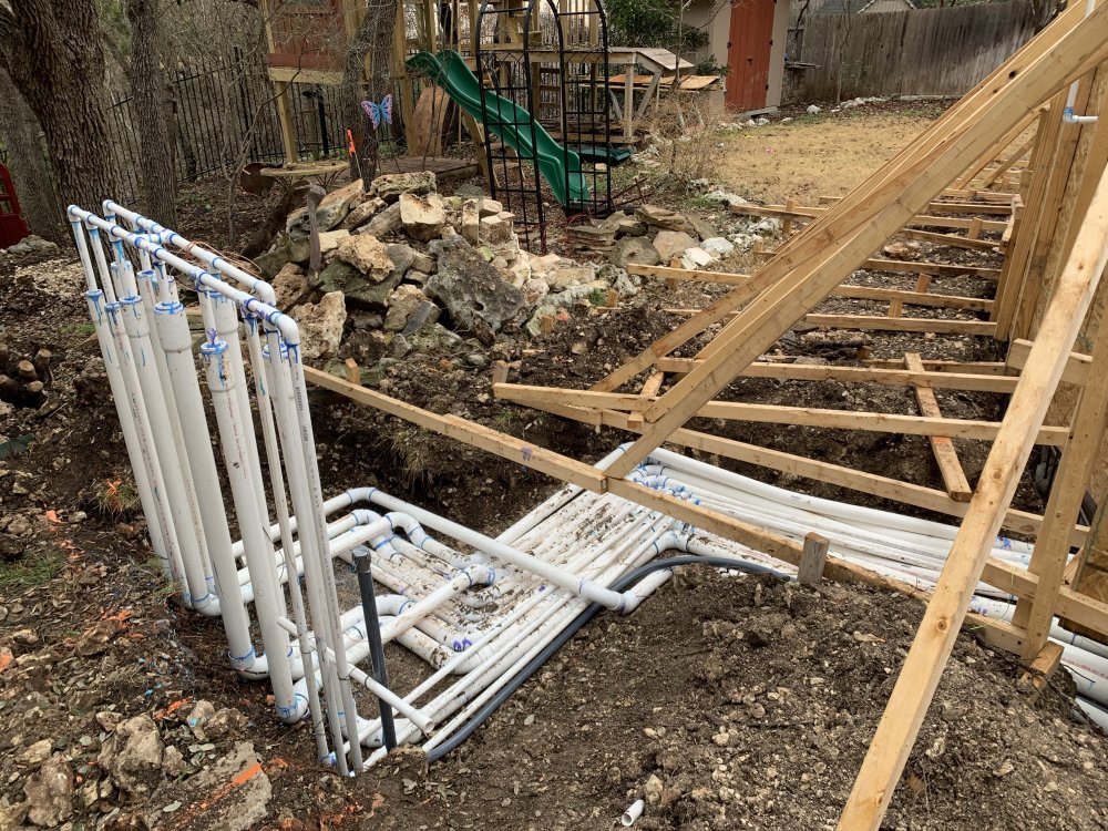

Furk we found more broken pipes this morning.  Oh well now the plaster job has turned into a rehab pipes also job.
 At least I have water to fill the pool after they plaster.  Wait, I can’t do that either because WD 10 is still under boil water?  Fine we will reschedule until next month.
Luckily it isn’t pool weather for a few months.  This is a depressing month.
it’s a jandy actuator, but looks pretty similar internally. i tried switching it with the return side and nothing. the toggle not working either. seems like it’s not getting power at all, yet it does turn over to the spa mode. it’s baffling. our build was completed in november so surely it’ll be covered under warranty, if i can get my builder to reply haha.
#1157
yeah, could be the little board gone bad then where the wires connect up in the actuator. Definitely if under warranty would wait for builder and manually adjust for now :)

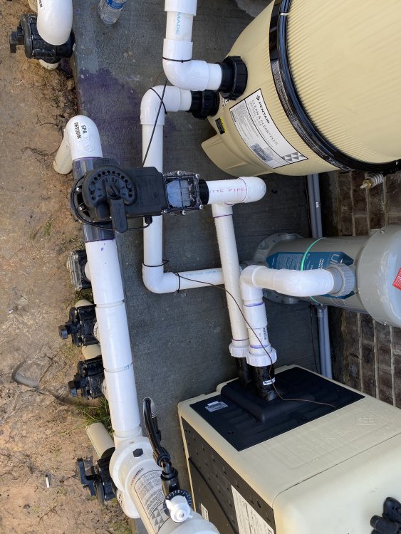

Was able to get my heater and actuator fixed. Replaced heater manifold, and pipe from heater return to a broken actuator that Tee’d to the pool and spa.  Was worried about removing actuator, but it came off pretty easy.  Sawed as close to it as I could, and cut the old pieces off, used a hot ass 3” rigid coupling, glue released.  Got a little close on one side with the saw. But it didn’t go though. All in about $600.00
#1188
What is that grey module between the filter and heater?
