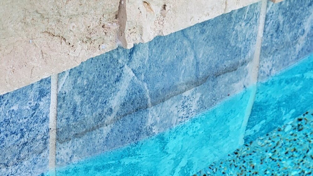

Need some second opinions. We recently finished our pool build, and they are about to finish the bathroom and kitchen area, thus completing the project.  We have 3 issues I raised and they sort of brushed them off:
1. Our pool pump pressure is kind of high. It runs at 3000 rpm, which is medium-high speed, and if the water goes through the UV/Ozonator and heater, it's 21 PSI. If I bypass those, it's 10 PSI. The builder says I should partially bypass those to get it around 15 PSI which is normal operation. My pool cleaner guy says that's wrong, and there could be an issue with the piping, something blocking it, or just poor design leading to excessive pressure.
2. We have 2 jets in the pool that constantly shoot bubbles. It's only those 2 jets, they do spray water too, but bubbles are constant. Builder says that's normal, especially with an Ozonator, but I don't believe them. Any thoughts on the cause of issue?
3. Pool has been up and running for about 2 months now, and we have a black stain or something on the water line.  Pic included. Our pool guy says it's not algae or organic. It won't come off with brushing or with acid. No idea what it is or how to remove it. Any ideas?

1.  You won't like the answer, but all you're really stating is 21psi is your system's steady-state pressure.  Piping diameter, length, elbows, pumps, fittings, valves, filter state, etc all go into determining your pressure.  Each of your components are also pressure rated, and should be plenty safe for 21 psi.  So, my bet is shitty design.
2.  Maybe.  You could disconnect the power to the ozonator / turn it off and run your system for a few hours to see if the bubbles go away.
3.  Go buy tile cleaner & CLR.  One of them should get it off.  Or, go buy a couple of pumice stone cleaners.  It'll be safe to use on your tiles.

for #1, I don't think 21 PSI is "too" high, maybe higher than ideal, but still within range. (<25). I would re-check the filter to make sure clean and not clogged up, can happen quickly on new build, but I don't think partial bypass a is normal design.
for #2 it is likely the Ozonator, you can pipe in a MDV (Mixing De-Gas Vessel) to remove the bubbles from getting to the pool if it bothers you. (~$1k from what I see)

Yes.  And it's creating calcium "barnacles" on the pool's plaster.
