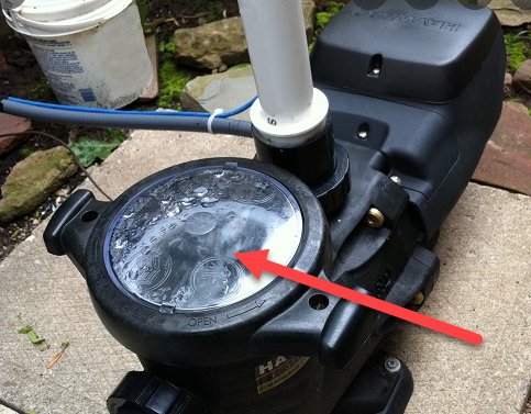

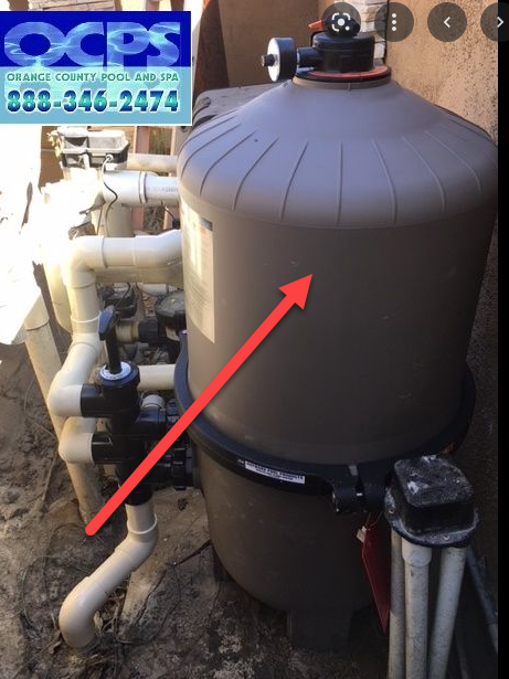

#2552
Not using pool service. The filter on the pipes (by all the pumps) has a bunch of junk in it. Can I clean that out? Pool builder told me a pool service would clean it a couple times a year.
#2553
Are you talking the pump basket?
Or the cartridge filter?
#2555
2 minutes ago, kmac30 said:
First one
Turn off the pumps.  You have to close off the drain valve to the pump if it is lower than the pool water level
I use a rubber mallet to loosen the lid.  They are friction fit.
Empty the basket and put it back
Put the lid back on, open the valve again
Turn power back on.
You may have to let air out of the filter housing after this.

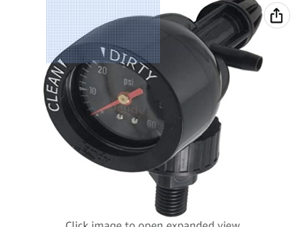

#2557
15 minutes ago, kmac30 said:
Thanks. How do I let air out?
top of the 2nd pic (cartridge filter)... the orange value.
Turn off pumps and then open the orange value and it will let air out and the lid to pump filter comes off easier.
Close the orange valve
Once pump lid back in place, turn pumps on to 100% to prime
when you see water coming into the pump filter under the lid, open the orange valve up slightly and air will come out. When air stops and water comes out, close it.
Might repeat that open slightly / close until the bubbles under the pump lid are gone
turn pump back to normal speed
Edited by MonkeyDoughnut
#2558
Where the pressure meter is on the top of the housing should also be a valve.  Usually a twist style.  Pump has to be running.
Edited by TexasEd

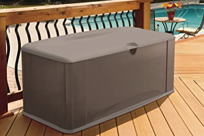

#2576
3 hours ago, PantsTent said:
Deck box is the keyword to look for. As with all things pool related, you'll find a huge price range and who knows on quality. 2 yrs and no issue so far on this one:
https://www.amazon.com/gp/product/B01HDPY7RG/ref=ppx_yo_dt_b_search_asin_title?ie=UTF8&th=1
We have the same box, or extremely similar.  Has been great so far but only 1 yr in.  It’s hold a ton of stuff.
