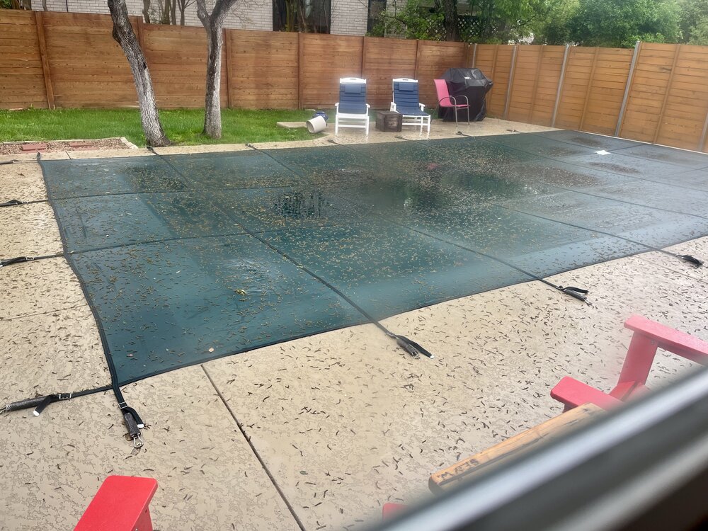

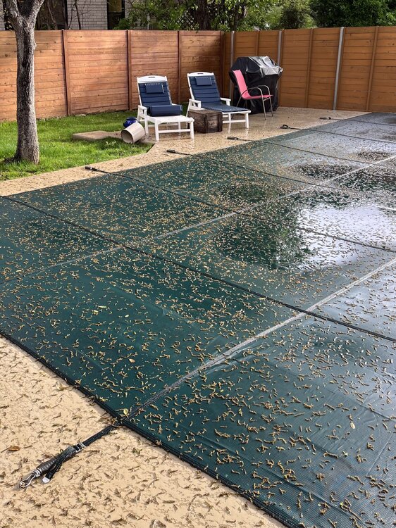

Got this thing installed just in time for the first big pollen dump.  Hoping it turns out to be $400 well spent.   There’s pros and cons but I’m thinking that sweeping this off when it’s wet or blowing it off when it’s dry is going to be better than emptying my skimmers 5 times a day and stressing about it every week when I’m out of town for a couple days.
That seems to be about 10 mins of pollen drop for mine.  It’s a rough 3 weeks or so. Any way to attach that thing without the screws in the decking?

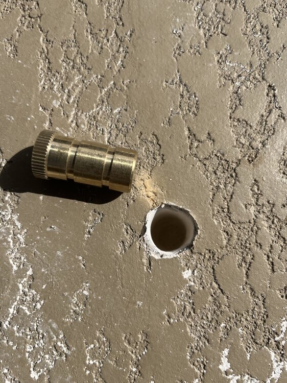

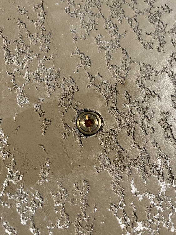

As I was reading up on it there were lots of reviews from people who tried using stakes in the grass unsuccessfully.  Each strap is attached to a spring that’s under fairly high tension.   I wasn’t real excited about the screws either but the last two springs broke me with the pollen. I am away from home two nights a week, occasionally three and leaving it alone for that length of time is too much. Same with the oak leaves when they fall. A few weeks ago I came home from a trip and the skimmer baskets were so full that it impeded the flow of water completely. It worries me for the pump.
The screws are in a brass anchor. The anchor is flush and when you remove the net for swim season you can turn the screws down to be flush as well.  Not sure how or if that would work in a nicer deck with travertine or some other kind of tile.
Yeah I’m travertine on 3 sides. But think I could sink them just past it, maybe. If you really committed to an anchor, not half assed it.   We’re in same boat. Have to leave often and I just turn the system off when I’m gone or pump would burn up in a day. The baskets are chock full in minutes sometimes.  You have a link to that tarp?

Do you have dogs? I have 3 dogs averaging 65 lbs that would just run/sit on this thing all day long.
I don’t have dogs. It would support their weight but I’d be worried they tear it.
unrelated to that statement, I also stuck an inner tube float under today to raise the middle. There was one spot right in the middle that sunk enough to touch the water and stayed wet which prevented the leaf blower from being as effiective. I’ll know tomorrow morning if the innertube fixes that.
That's what has prevented me from installing one, but fuck, I am so fucking tired of leaves and shit. Almost 10 years of daily or weekly skimming.

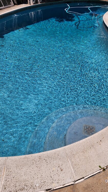

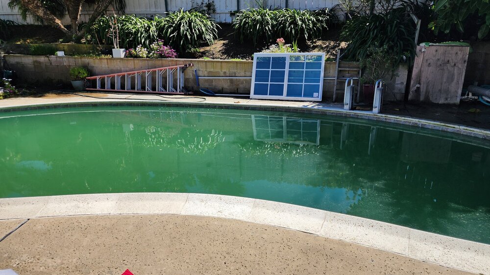

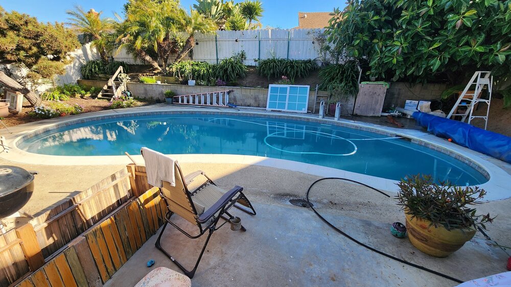

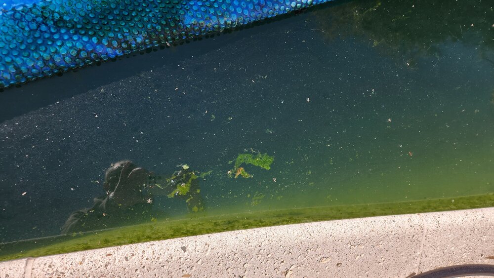

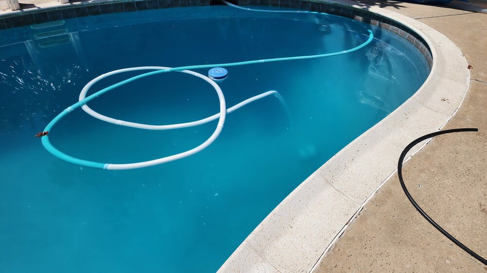

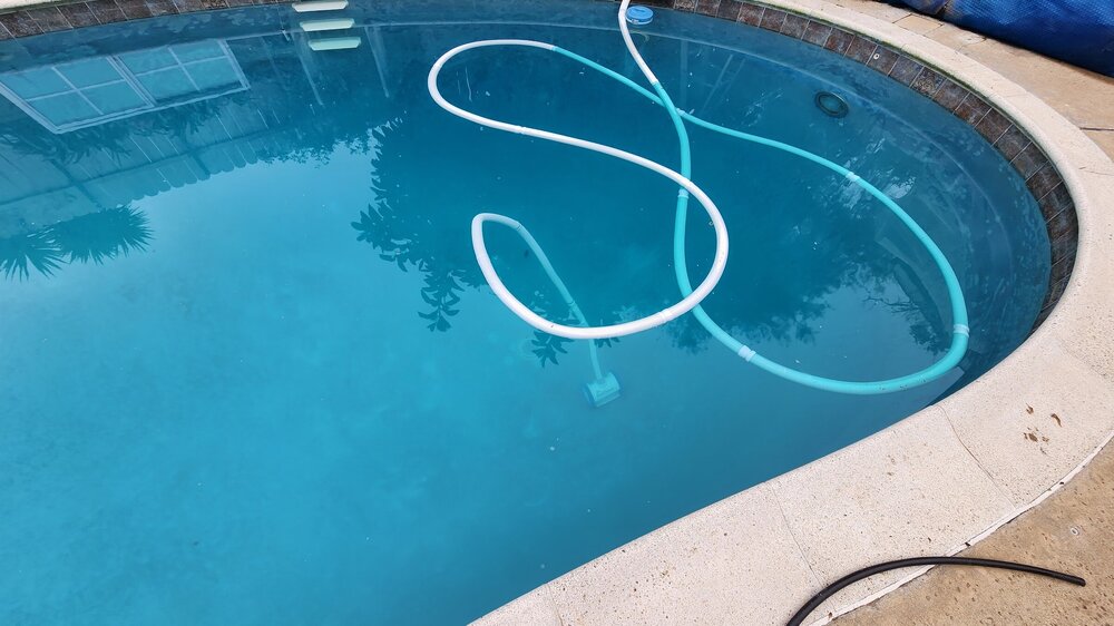

All right, my friends. Pull up a chair, grab a beer, and let me tell you the tale. The tale of the Great Algae War of 2024.
I shared already the state of the pool from last month. Here it is again:
ca. March 19th.
Now, this is no ordinary mess. To give you some idea, not only was the pool completely full of algae -- we're talking long strands from the surface to the floor, here, but I scooped up a goddamned pinworm off the surface. Yeah, you know those fucking intestinal parasites? Yeah. One of those. It was dead. No idea where it came from.
March 28th. I'm just about to go on vacation. One more glimpse.
Ew.
I dumped 10 pounds of shock in there and got the pump going. Also skimmed as much as I could off the surface. Went on vacation, came back home.
April 2nd. Back home. OK, that's an improvement. We're sorta bluish green instead of deep forest green.
Dumped 10 more pounds of shock in.
Tuesday. OK, now the color is correct, but you can't see deeper than the second step. I've used up about 12 chlorine tabs, too. But now it's clean enough that I can start running the vacuum; there's no huge deposits floating on the surface, and the green is gone.
Pardon the mess. We're having work done on our house and our yard is being used to store shit that was in what used to be our garage.
Yesterday. Here's the deep end of the pool. By this point I've disassembled and cleaned out the filter completely three times. You can see the bottom of the deep end, but it's still murky.
And finally: Today. You can read the labeling on the Poolvergnugen all the way down at the bottom of the pool.
All that's left is -- I'm going to dissassemble the filter one last time, dump in about five pounds of Sodium Carbonate (all that chlorine got my pH down to about 6.5), then put the Solar Blanket over it so it can start warming up. Now the solar blanket ain't clean, so I'll need to keep my eye on chlorine levels more or less daily over the next week. But other than that, we're done here!
Edited by Rimbo

And here I am bitching about small dots of black algae....good grief man.
You know if a put a bottle of chlorine in there every few days during the off season, you won't have to deal with an underwater jungle.

Great work, but it would be a few years before I would be able to swim in the pool.

My wife pretty much feels this way. Although her timeline is more like "never."
Me, I'm fine with it. I know how the filter works. The chlorine levels have been high enough over the past week to kill anything; even beyond that, DE filters everything down to about 3-5 µm. So a virus might survive, but e.g. amoebae are gone.
Just dumped in 10 lbs of Na2CO3 to get the pH back up closer to 7 after all the chlorine tabs that've been in there. Only thing wrong with the water now... is it's just too damn cold. Like 68 degrees.

We have a 9 year old Hayward 6060 0.5 HP Booster Pump for the leaf crawler.  It has been whistling for a while and yesterday it finally gave up the ghost.  Am I married to the Hayward Pump, or can I get a generic pump and just re-align the fittings if the input/output doesn't match the current piping?
#3247
Booster pumps are usually cheap. But, in any case, the wetside is probably okay and you just need the motor side. I replaced a 1.5 uprated motor on a Pentair whisperflo used for water features and it was pretty easy. I think $450 instead of a couple thousand for a new pump. The reason I did it is that I haven't found any good repair guys. I hired one company and he told me that since Covid the prices have skyrocketed and that the part itself was going to cost $2000 and then approximately $500 in labor. Fuck that noise.
The downside, I have some Intellchem issue that is keeping my saltwater chlorinator from working properly. The online stuff that I have found so far is outdated so I may have to find a repair guy who knows his stuff. That equipment supposedly only lasts a couple years and only controls acid which is easy to keep in range manually and the parts are expensive - acid pump is $500. New pH sensor and ORB sensor are $200. New computer module is $1500. It really is a waste of money.
