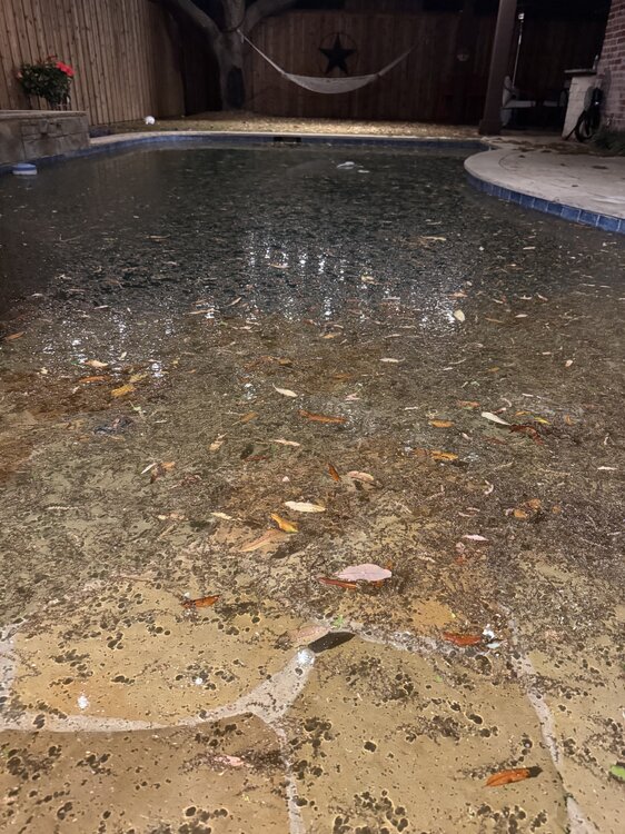

9 hours ago, HiggyBaby said:
For anyone contemplating live Oaks near their pool…. my recommendation is maybe no. IMG_0634.thumb.jpeg.d0012fa81216aaab5e93996d8f3759ab.jpeg
yeah, I have a massive live oak that overhangs the pool and it is a daily fucking beating

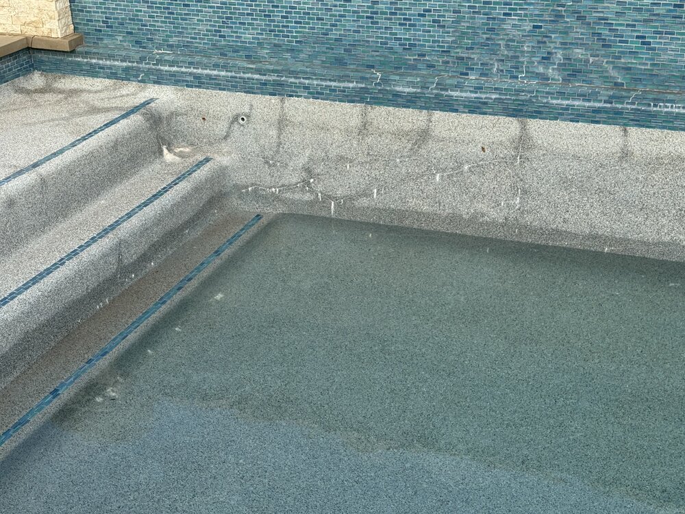

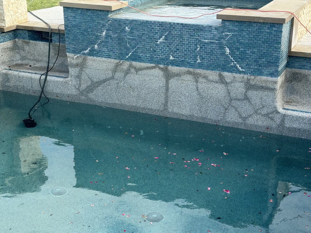

Anyone know about pool cancer? We’ve never had any signs or symptoms. The pool was finished in early 2019. I don’t know who the concrete supplier was. We may be selling the property and a potential buyer wants to test the pool, despite it not having any symptoms. Opinions?

Is there really a scientific way for a lab to test the pool concrete mixture for the “cancer” ?? What will they rely on?
If their lab says it got the cancer do you have to disclose to other buyers even though the pool is fine as of now?
I assumed all the pool cancer issues would have developed by now
Unfortunately we are dealing with it now. Look for white lines (these are the cracks) visible in the pool. We noticed the first crack in the spa bench. The dark lines are all the cracks so far.
The only way to test is to have cores drilled out and sent to a lab for testing. We did not do that only because it’s obvious because of the visible damage.
Is the solution to tear everything up and redo the entire pool?
#3322
Yes the only fix is rip out and rebuild.
I'm in the same boat.. No, pools are not worth it.
It seems there are thousands affected and very few have or likely will see any compensation. My builder went OOB. The concrete company that mixed the faulty concrete is OOB. The  respective insurance companies are finding any reason to not pay out.. it's a mess.

mentioned upthread, also have concrete cancer. our builder filed claim with his insurance 6/2023 and we just now heard from them in february. they notified us of a 2 yr statute of limitations where if we haven’t filed suit, we lose the option to. they also said they were working to settle the claim and that we could send over estimates for rebuild. we got a few and they came back basically twice as much as when we initially built in nov 2020.
we’re going to continue to hound the insurance for the next few weeks and if there’s no settlement offer, we’re going to have to file just so we don’t lose that option. fml this is the worst.

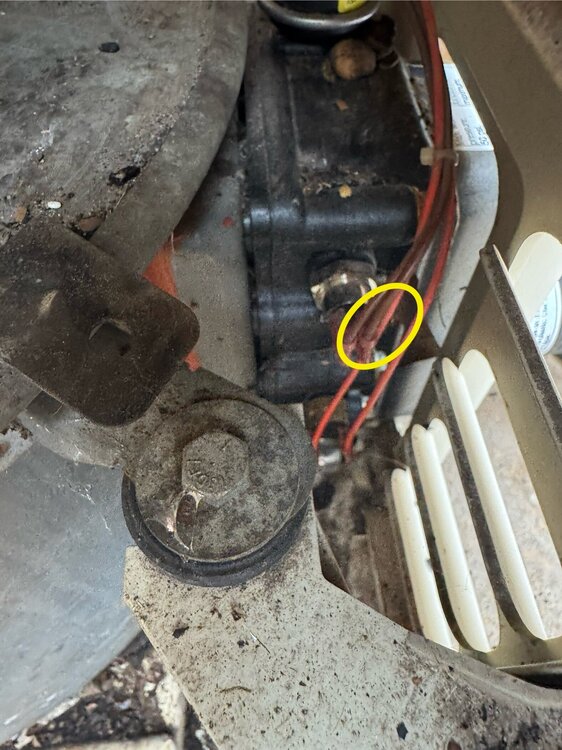

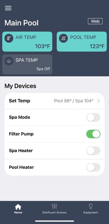

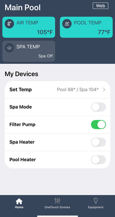

Moot point now since the temp is coming up on its own, but I was trying to run the heater earlier this weekend to bump the pool temp a little. It runs for about 3 minutes before going into standby because it thinks the pool temp is hot enough. Where is the fault here? Does the heater have an internal temperature sensor that’s gone bad or am I getting a bad reading from the main pool sensor which is installed in the PVC near the pump. For reference the pool temp is around 77° and then when I run the heater it spikes to over 120° and shuts off the heater.
Edited by HiggyBaby

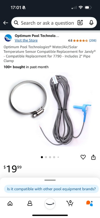

Don't know what heater you have, but sounds like your water sensor is going flaky.  Maybe go out there, wiggle the wire around and see if the signal changes on your readout.
#3348
It’s a pentair master temp. I went ahead and bought a water temperature sensor off Amazon since they’re cheap and easy to replace but the fact that I’m getting a temp readout at all makes me wonder if something else is going on. So I took the panel off the heater and checked the connections on the thermistors and noticed the one on the intake was loose so I snapped it back in and now everything‘s working. It could just be coincidence, but I guess we’ll find out… if it happens again I’ll swap out the temperature sensor but fingers crossed. IMG_1323.thumb.jpeg.003f297874ae45bd3335045cdc80a2a9.jpeg
