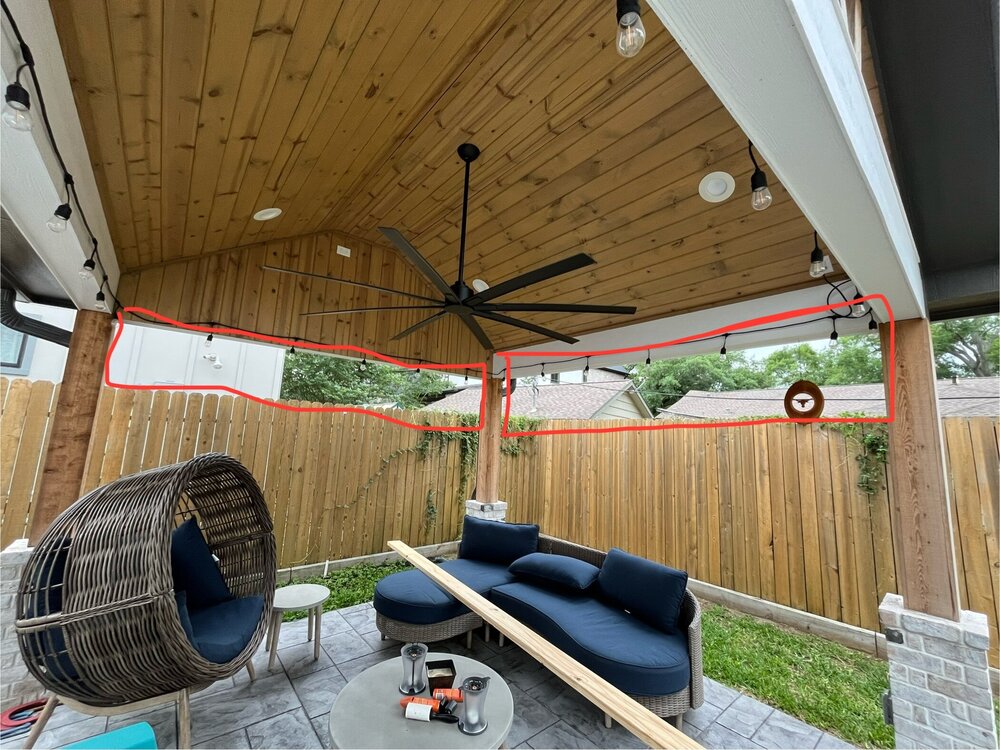

We have an outdoor patio. This picture is facing approximately west, so we get a couple hours in the afternoon/evening when the sun is blazing between the roof and the fence.
Would like to buy some shades. I was thinking the roll type, but I’m having trouble sourcing some wide enough. The distance between posts is about 13 feet. Only need them to be about 2-3 feet long. What other options are there that I should look at?

Yeah, I couldn't find anything longer than 115in (9.5 ft) for roller. TBH anything longer probably not practical for roller.Ā  If only needing a couple feet drop as well they would be overkill price/use wise.
I'd consider maybe just going with drapes that you can pull shut as needed. It's going to be much cheaper and easier for the couple hours your thinking, plus would offer noise/privacy at other times as needed for those sides.

Had that thought, too. We could either do full length like your picture or even just little short ones (might look weird? Question for the wife.). With a 13 foot span I'd probably have to support them in the middle.
Other thought I had was some sort of hanging (fake?) plant situation.

I'm looking to add drapes to our patio as well. Already have roller, would like drapes for winter to keep warmer and cut down wind.
Will need support in middle, but can getĀ  "C"-hooks that will slide over the middle support so drapes can go full span or pulled to either side.
On length, I'd be concerned shorter ones wouldn't be heavy enough to not sway with the wind and blind people periodically who are looking that direction.

I have something similar. I used turnbuckles and wire that I string across the span, used some eye hooks to give it stability in the middle, and attached carabiners to the outdoor curtains to secure them. I take them down when we aren’t using them. It doesn’t take long at all and they are easy to put on/take down.

are you opposed to having a split across each span? likely will save money, even if you do find one long enough.
see if you find one you like, go and look a few places, and reach out directly to the manufacturer. i've been pleasantly surprised with the information i've gotten from them about this.
not inexpensive but costco has a deal with sunsetters for 20% off. here are their prices, and they go up to 12'
actually looks like they are 20% off right now from their site: https://www.sunsetter.com/c/easyshades/manual-easyshades/
Ā
actually, this company sells what you probably need, in widths up to what you are looking for for ~650 per shade if it's 13' x 3x
https://www.maantaoutdoor.com/exterior-roller-shades/14367-reef-roll-custom.html
they have cable guides, which is important for what you need since it isn't going all the way down

Last house I had I bought drapes that had grommets on the top and bottom. Bought vinyl coated steel wires, clamps and eye hooks and ran them thru the top and bottom grommets. This kept the drapes from blowing in the wind enabled us to fully open or enclose our patio by sliding the drapes open or close. When bad wind occurred I’d just slide the drapes to the side and strap them to our pergola posts.Ā
Ā
new house we had a company come out and built custom sized motorized shades for our patio. They fit tight all around ceiling, sides and floor of our patio to create walls that keep bugs, sun and weather out. Operate them on schedule or by mobile device.Ā
