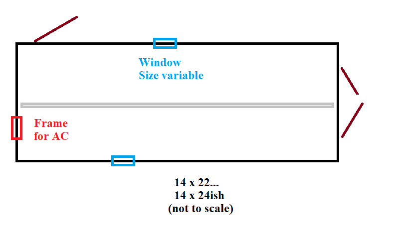

Where do you live, @After irth?
We can build better & lower cost than anything you find via the "Tuff Shed" type co's.
The thing to do is DEFINITELY do a "block & beam" (pier & beam but no drilling into the Earf for piers).  If it's built correctly & access is available, you could sell it & someone can move it out.  You also get a lower tax rate vs. a slab.  The typical maximum you can get down the road with is 14' wide.  Mobile homes are max 15' wide per DOT regs.
If you DO want to make it permanent, then a concrete pad is a possibility but it will cost more.  I'd also suggest you try to do 14' (even if you go 14' x 20') because that extra 2' of swing space is a good idea.  It's like a tractor... I have yet to hear someone say they had too much.  It's not that you're attracting too much crap, but it does allow for better organization.
Add a window or two on one of the sides & with a removable screen, you can bring longer pieces in.  A typical design will have a set of double doors on one end, single person door towards the other but on the side.  Give yourself the ability to get cross drafts.
Even if you don't install one, frame out for @ least ONE window type AC unit... maybe even two? (added reinforcements in the 2x6) & stretch the walls as high as you can get (a good height is a 10' interior... you can easily loft that for storage, material, whatever).  If you intend to do something like woodwork, a spot kinda low for connecting a dust extraction hose is a good thing as well.
Also, give yourself as wide a soffit (overhang) from the roof as is possible (unless you intend to put gutters on... in that event, go "normal").  Wide / extended roof lines = better prevention from water splash back & your drip line is extended.
Put receptacles wherever you can fit 'em... more is better, but pay attention to the distance from any kind of electrical service & be sure to have available knockouts for expansion into the shed.  Add power overhead for a few long LED's.  More light is better.
If you want metal skin, that can be done & goes up fast.  Whatever you end up doing, damage from the inside of a shop happens more with some kind of lumber or whatever poking than damage from the outside.  I have a 14 x 24 & it's similar to the attached sketch but no windows or AC frame out.  It's 20 years old & in great shape.  Purchased it before I got into the construction trades & I added a 1/4" plywood setup on the inside from the 4' height down (8' wide pieces).  Went with 1/4" due to weight, didn't add insulation but I could easily slide that down between the studs.  Plywood is screwed in so I could remove if needed for any reason.
& A ramp.  You'll want to pay attention to the yard / lawn / land slope & get a ramp for easy movement of tools, lawn mower (riding, push), whatever.  A permanent ramp will have weather issues. so think that idea in advance if you want a fixed 4 or 5' wide x 8 to 10' long ramp.  Bigger is def. better but also heavier & harder to manipulate.
Fully weathertight @ the base is gonna be interesting depending on the type of doors you go with or slab on grade, etc. because some generic varieties build onsite will have issues with a tight fit... gaps WILL be present in some of those.  & I mean the accessibility of mice, scorpions, etc.  If an ant wants in, that's a done deal & you won't really be able to stop that from happening, so try to keep snacks away... not even a wrapper in a trash can.

All good stuff!  Thanks for the input.
I live in Lufkin, by the way.
