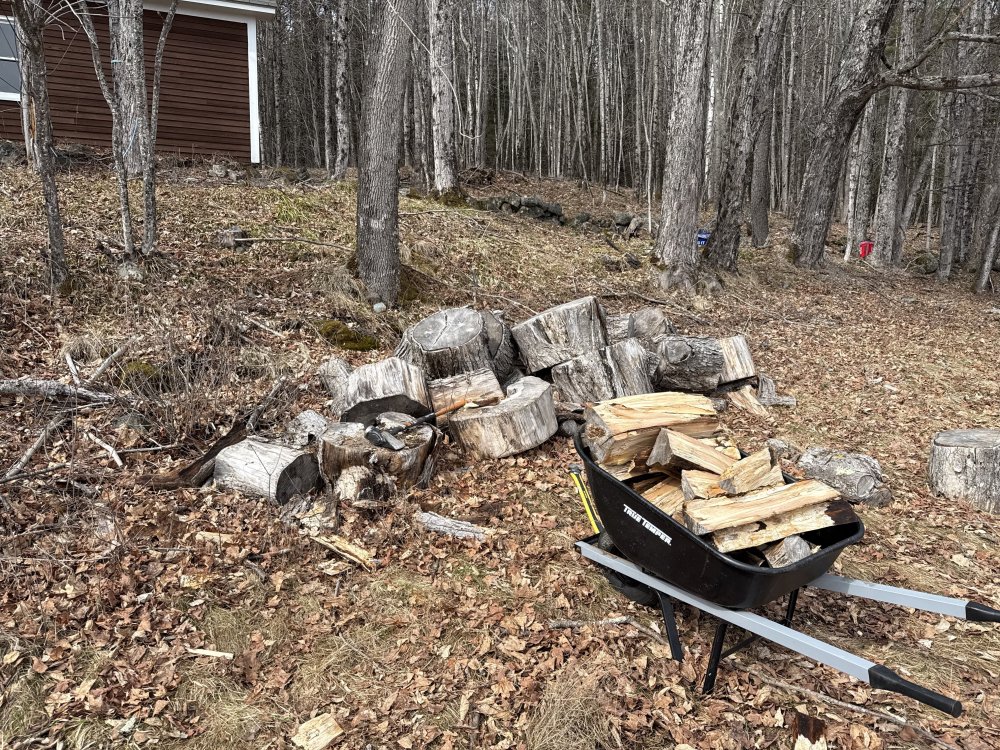

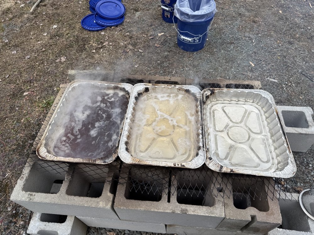

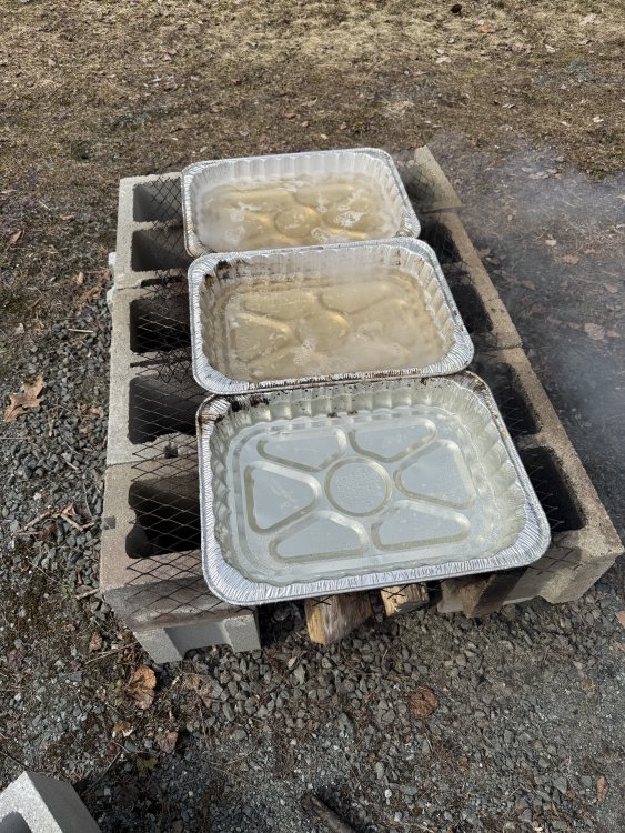

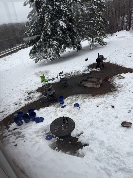

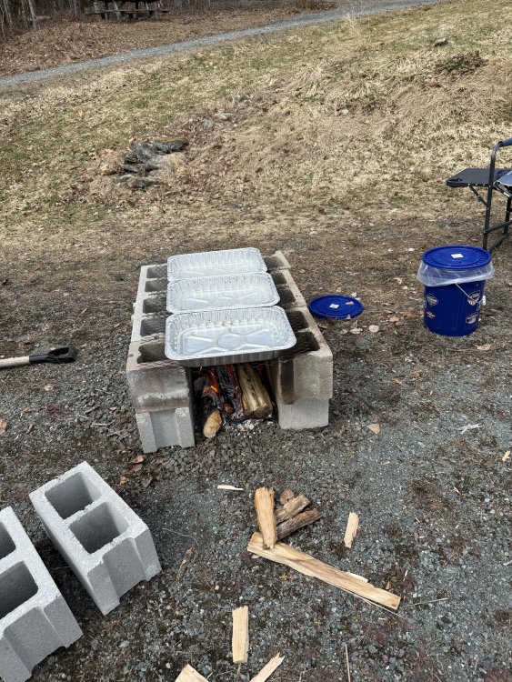

Session number two is going to heck of a lot better today. We’re well into the production process. Things are looking great. Had to use the old set up because I forgot my new tray. But that’s all good. This works really well tried and true.

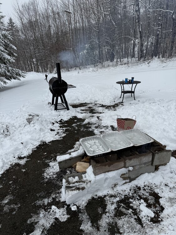

Setup
getting wood
Sap in the buckets
Thickening up
and getting close.
I might get a half gallon today.

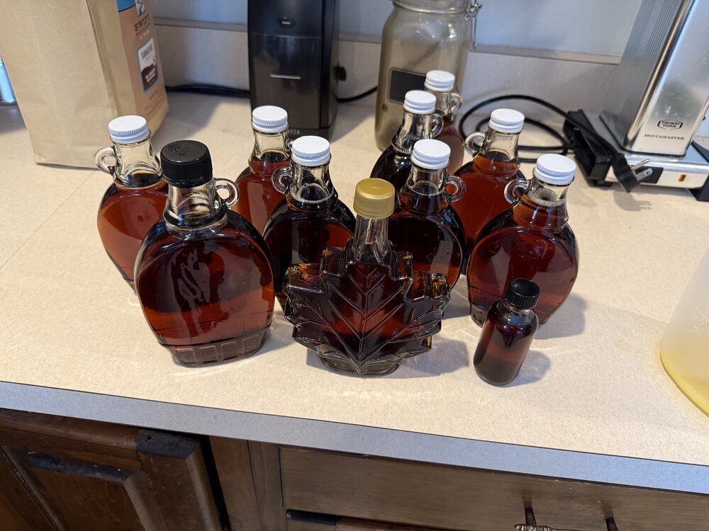

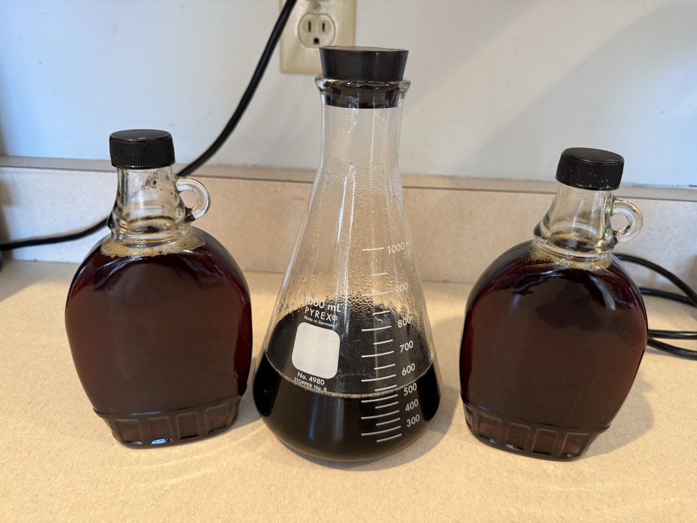

I ended up with just under a half gallon this go around. Here is the yield for this weekend.
we’ll give it a go this coming weekend again.

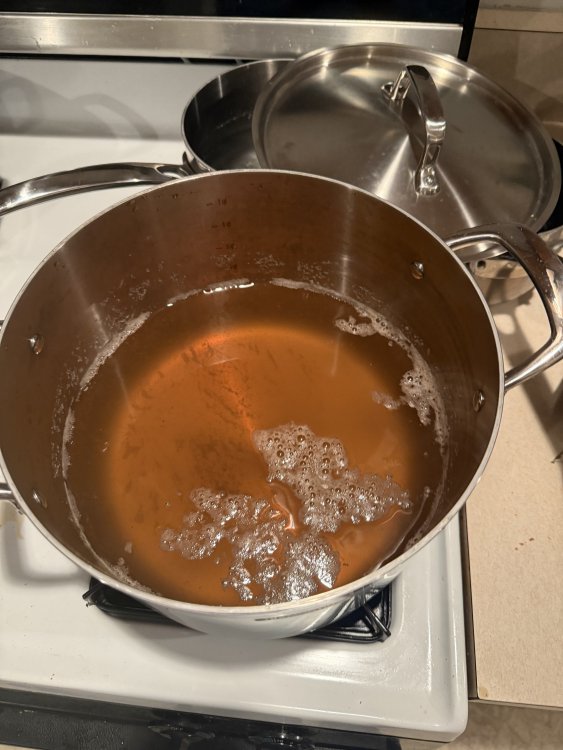

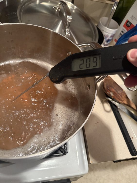

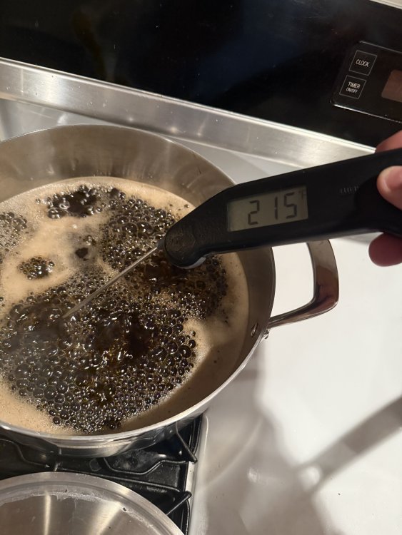

I missed a few more pictures. When bringing the syrup in I ended up with 2 “batches”
and

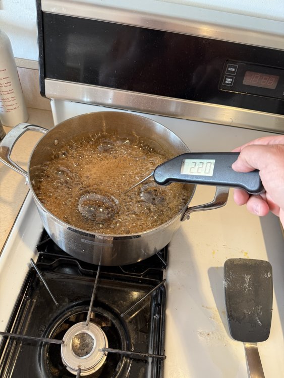

they boil at different temps
The light was boiling at 209
the dark at 215. I would eventually combine them and get it done.
boiling at 220.

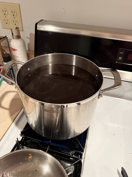

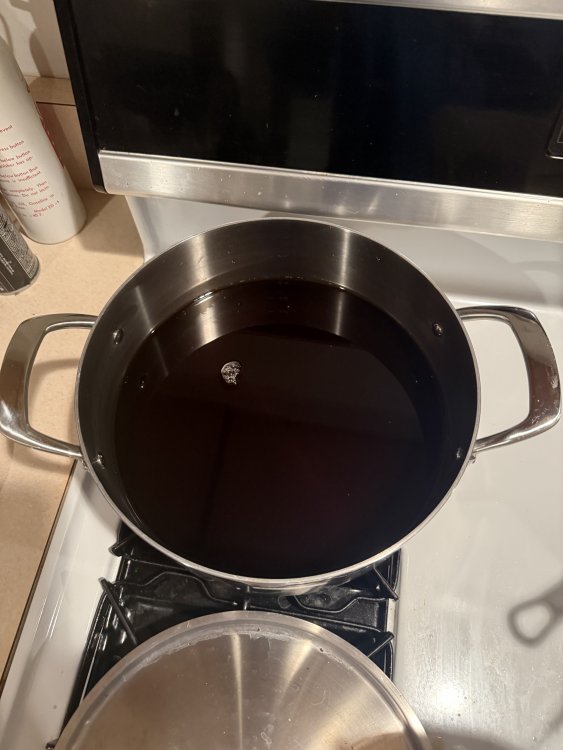

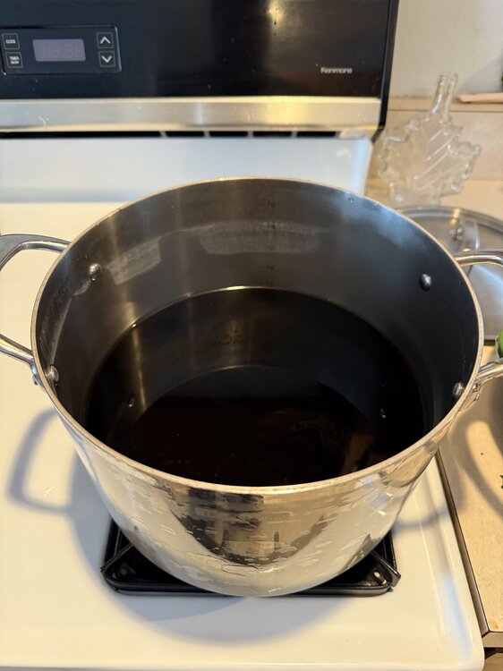

Brisket is done. Sap is still boiling. I have some of it on the stove now since it needs the boil off.
This is going to boil down to around a 1/3 of this I would guess. We shouldn’t get a full gallon today.

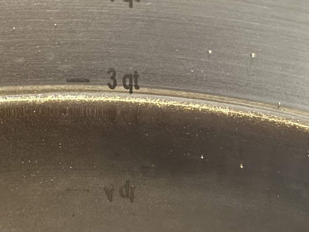

This batch ended up with 3/4 of a gallon
Will need to clean up today.
This batch
One downside about this batch- I didn't realize I needed to do one last filtering on it and I have sludge in about half the bottles, I am going to need to fix that soon.

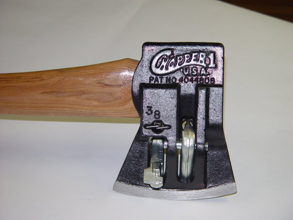

I will give a quick review of my choice of axes for the lumberjacking
My initial axe is a Collins Splitting Axe (similar to this guy). It's perfectly fine. Mine is about 10 years old. It works great on smaller wood that doesn't have any knots. This thing really struggles with knots and you can see it in the 2nd picture stuck in a piece of wood, I would take a day to get that out. It's actually pretty cheap and dulls quickly, but give it an edge and it's good for a day of work.
My FIL saw my struggling with knotty wood and bought me the Fiskars Splitting Maul. Technically the IsoCore 8 lbs. Forged Steel Splitting Maul with 36 in. Fiberglass Core Handle. That thing is a beast. I am able to split the wood that gives the Collins axe trouble. Is it perfect? No, but due to the weight/shape if I get a log clean, it usually will split the wood no problem.
Both aren't bad, but you gotta get the right one for the right job. Though the Collins struggles have kind of put it back burner for me right now.
Chopper 1 is the shit
