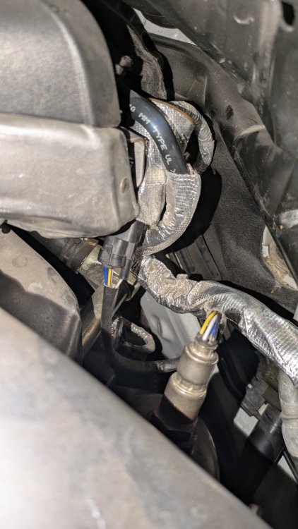

I am so goddamn pissed off.  Got a CEL, pulled the code, upstream O2 sensor.  $40 part from Rock Auto, secured.  The sensor itself is easily accessed.
The connector, however, is not.  As near as I can tell, it has a lock tab that must be pushed up before the connector can be separated.  But the tab is on the "obverse," you can't fucking see it.  And the connector assembly is pinned/clipped to a bracket with one of those goddamn infernal clips, and the whole thing is covered by a heat shield that I can't move sufficiently out of the way.  If it were rotated 180 degrees this would be easy peasy, although I understand these things can be a bitch to separate.
A fucking plastic clip is gonna cost me like $200.  Motherfucker is sitting there mocking me.
Just venting, but if anyone has any suggestions, I'm open.

So, I just was procrastinating this because I got mad about having to pay someone to do it.  Figured I'd wait for some rough running or a blinking CEL.
Well, the CEL went away.
The code was P015b, which is O2 sensor "delayed," which I interpret as a precursor to failure.  It was also cold as balls when it tripped, as I recall.
Anyway, I suppose I'm still on the hook for the 02 Sensor, but I can safely put it off a bit longer.

As can be seen from the photo above, both ends of the sensor are accessible at least somewhat.  The problem is two-fold:  I can't easily get to the "obverse" of the connector to actuate the lock and separate the connectors, and I don't know exactly how to actuate the lock.  There is a red tab that needs to be pushed up and that I can do, but there may be something that needs to be pushed to release.
The service manual may go into that detail, or not.  I can't find anything definitive online.
And, even once I determine how to unlock the connector, I'm not sure I can separate the two ends.  It seems that the two pieces can be quite stuck, so even if I had a tool or the ability to otherwise actuate the lock, it seems I might need two pair of channel locks and another pair of hands to get it apart.  And, at that point, things are getting pretty tight in there.
Unfortunately, from an engineering standpoint (no, I'm not an engineer-lol), the procedure will likely involve removing whatever is in the way of accessing the connection. This procedure is what they'd use to determine the flat rate labor time required to complete the repair if you took it in for service. A tech whom posseses experience and can complete the repair without having to use that procedure is how they cheat the system and still get paid "1.5 hours" or whatever number of hours of labor for something that takes them 10 minutes.

No, it's "pinned" to a bracket.  There is some way, probably using a proprietary tool, to detach the connector from the bracket, but that's another one I can't quite work out.  Although, I did just have an idea.

Not sure that really solves my problem.  It's the non-sensor end of the connector that I can't access well.  And then, even if I could actually separating the two may be difficult.
Also, I see from the internet that a common problem is the sensor itself strips the threads on the exhaust manifold on the way out leading to a potential need to chase the threads or, even worse, cut out the threaded lug and weld in a new one.  The way this is shaping up, that would happen to me.
