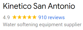

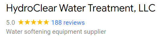

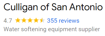

Yeah I checked with a few more places the terms for the three we narrowed it down to are as follows:
Culligan:
$2578 w/ Install and taxes
Service Calls: $95
1-5-10 parts and labor
12 or 15 gal/min - Model Dependent
Resin/Carbon replacement every 6-10 years priced at $800
Kinetico:
$3725 w/ Install & Taxes
Premier 2030 Model - Non Electric
Service Call: $70
10 year parts year warranty, 1 year labor
16 gal/min
Resin & Carbon replacement 7-10 years at $900
Hydroclear:
$3000 w/ install + taxes
Westinghouse Brand
Service Call: No Fee
Lifetime Warranty
13 gal/min
Resin & Carbon replacement every 10 years for free(Part of Lifetime Warranty offered).
Our house will be  pre-plumbed which basically gave us free install on all the above featured. All the above systems are metered systems so it will only refill when needed vs a set schedule.
