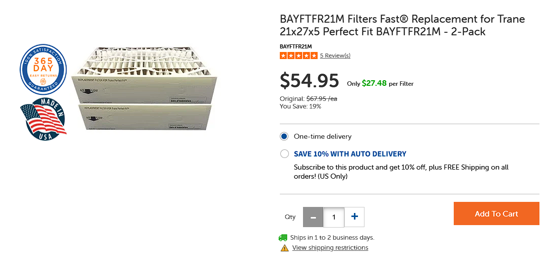

there's a company called "Filter Time".  Dale Earnhardt Jr. is their spokesman.  You "subscribe", and they send you filters every 3 months?  I don't know, I've never used the service, but it makes sense to me. Filter gets delivered, guy that receives filter remembers that it's time to change it.
https://www.filtertime.com/air-filters/select?utm_adgroup=FT-FiltersSubs-Google-Brand-Search&utm_term=filter time dale jr&utm_campaign=FT-FilterTime-FiltersSubs-Google-Brand-Search&utm_source=google&utm_medium=cpc&utm_content=&hsa_acc=4713533615&hsa_cam=21807669747&hsa_grp=168458932706&hsa_ad=717324941506&hsa_src=g&hsa_tgt=kwd-2299391612862&hsa_kw=filter time dale jr&hsa_mt=e&hsa_net=adwords&hsa_ver=3&gad_source=1&gad_campaignid=21807669747&gbraid=0AAAAAC7wDJ0ftOns2eAoHUp_hBSy0fhTz&gclid=CjwKCAjwyb3DBhBlEiwAqZLe5KWNoiEuEqBw0ayCW7gtoLUoPO0kgNWJ0euzhXUFLU1j0wpDlA7e1hoCLFkQAvD_BwE
