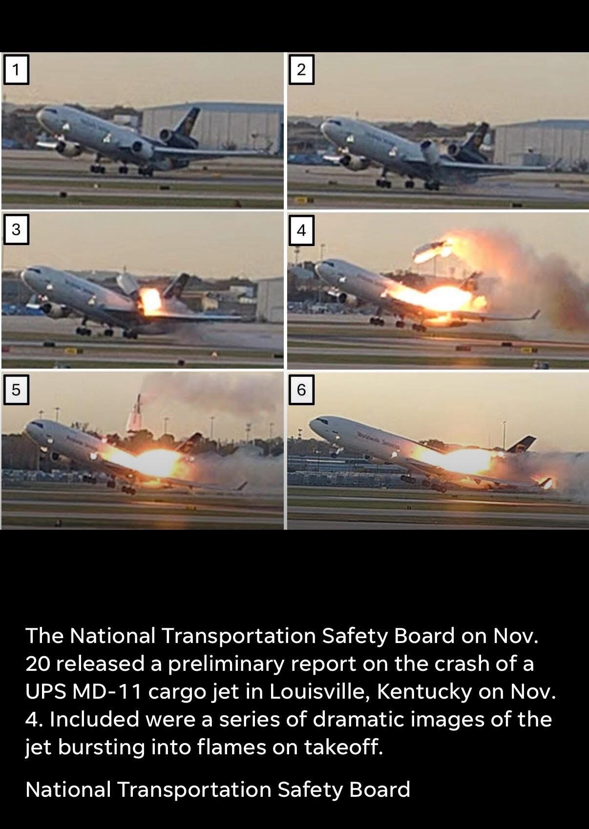

NTSB says based on video they have the pylon was still attached to wing after the engine came off.  That means it’s a different failure scenario than AA 191.  They've asked for maintenance records from ST Aviation in San Antonio where the airplane had its last heavy check (and therefore where the engines would have been removed).  They also said the takeoff roll was normal until 37 seconds into it when a persistent bell started going off on CVR.  The bell lasted for the remaining 25 seconds of the flight.  They did not say this but per Google an engine fire will trigger a warning bell.  On these older airplanes there is a fire loop which is essentially a metallic circuit that melts and breaks the circuit when there is a fire (and is the source of a lot of nuisance alarms.)  interesting to see from wreckage if the fire handle was pulled although it probably wouldn’t have mattered since there wasn’t enough airspeed to recover and the fire bottles would be on the runway
Edited by ClubWhatever
Yeah I think I heard that wrong.  Now I think he said the pylon was attached to engine and came off with engine.  That is the AA 191 scenario.  The way he says it is confusing to me so I am not sure.
I understood it this way.
Last line of this article blurb quotes the NTSB as pylon structure still attached to wing.

Fucking hell.  Looks like complete engine/pylon separation happened FIRST.  That is, the engine didn't blow and have its disintegration cause structural failures - looks like the structural failure happened, causing the catastrophic damage on its own.
And yeah, they were already nose-up and almost airborne.....no possible time or way to abort takeoff.  Furk.
Holy shit.
Did the pylon separation rip open the fuel bladder in the wing and then ignite it?

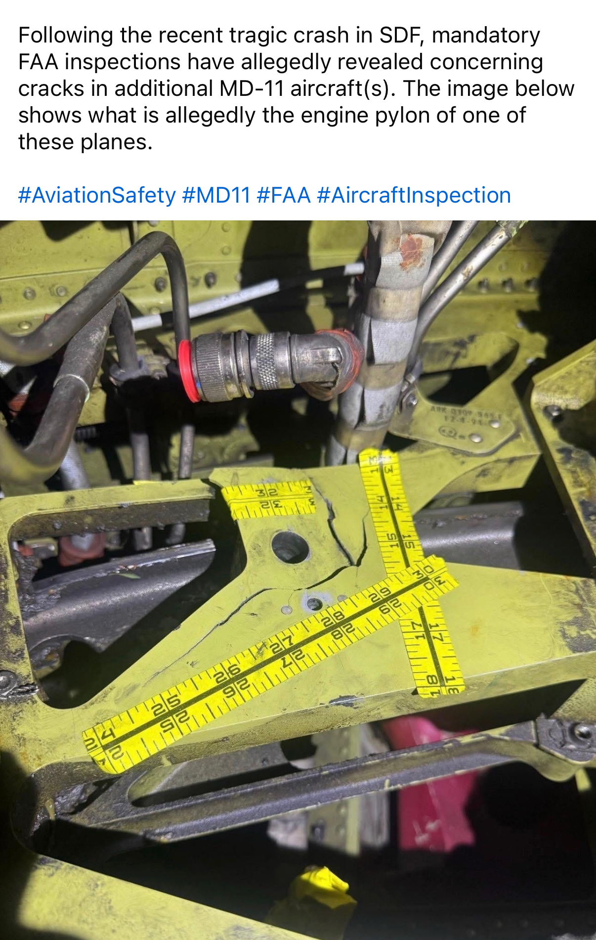

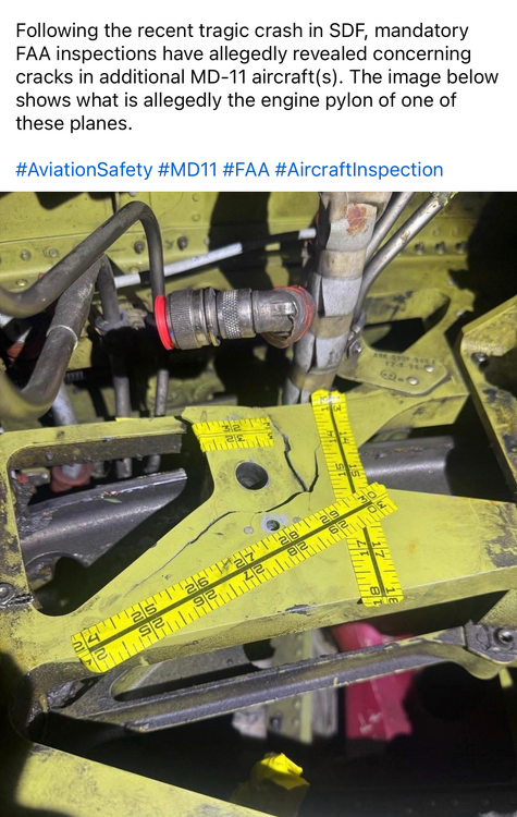

This has been circulating too.

Different cause same results. But yeah. All the three fan trash cans are grounded now.
That seems...sub-optimal.
Really is gonna end up being a lot like AA 191, isn't it?  Maybe not caused by a maintenance procedure, but consistent pylon stress of some sort leading to failure, systemically.
if that really IS a picture of the pylon... holy fking shit... how the HELL was that not noticed before.
I know from the disaster plane crash shows that products that are supposed to be under a lot of stress are supposed to be visually inspected, along with spraying a UV light sensitive solution that glows on hidden stress cracks.
a crack that bad means no one has inspected that piece for a very very long time.

Gonna need more tape than that to hold it together
The last inspection was 4 years ago.  The cracks were on the inside of the lugs where the bearing is, but away from the exposed face.  No way to see them even if the pylon is removed.  The bearing would have to be removed too so you can see the entire hole.  Will be interesting to see what the inspection actually called for.  I’d wager the bearing was not removed.
Also, the cracks seem pretty small for there to be complete failure.  It looked like there was less than 20% of the material cracked when it let go.  Doesn’t seem like a very robust design.

its a picture of A pylon from another MD plane, not THE pylon.
It’s been a long time since I worked on this type of airplane but that looks like part of the horizontal stabilizer support.   I worked on one that had a similar crack. The McDonnell Douglas engineering team was pretty freaked out by it and insisted on fixing it themselves.   They said it was not very many cycles from letting the stabilizer break off.
