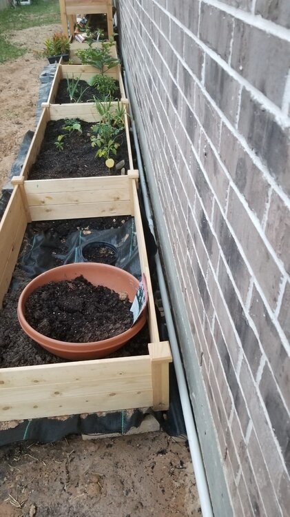

I'm installing drip irrigation on raised beds.  In the pic you see the gap between the house and the beds where I'm planning to run the PVC line.  What should I put on top the PVC to keep weeds away and protect the PVC from weather?
19 hours ago, cactusflinthead said:
I really don't like cloth. I have yet to see it truly prevent weeds. Any Bermuda left behind will continue to grow and will eventually emerge. It tends to get embedded in the cloth. If you are going to aggressively hunt it with chems it's doable, but I still prefer a nice blanket of mulch. Newspaper and cardboard are fine. At least I can extract the grass that's appeared without having to chase it through the cloth layer
Ain't that the truth, fuck that annoying crap. I've been in landscape fabric hell trying to get all of it pulled out of the area I cut out for the bed. There was a previous circular planter about three feet in diameter with a lantana bush that died from snovid and they landscapers laid down an excessive amount below it. I've dug down below it with my shovel and hoe but it just pulls apart like pieces of cotton candy. I've been on my hands and knees sifting through the dirt trying to get as much of it out as possible.
I'm definitely going to use the cardboard/newspaper system instead with mulch above it. Thanks for the tips.
Maybe put some newspaper down below it and cover it with mulch or light gravel?
Gravel is my rec. It's going to be exposed to the weather so figure on draining it in the winter. Some pre sprinkled in the gravel should keep most of the weeds down. Spray the strays.
