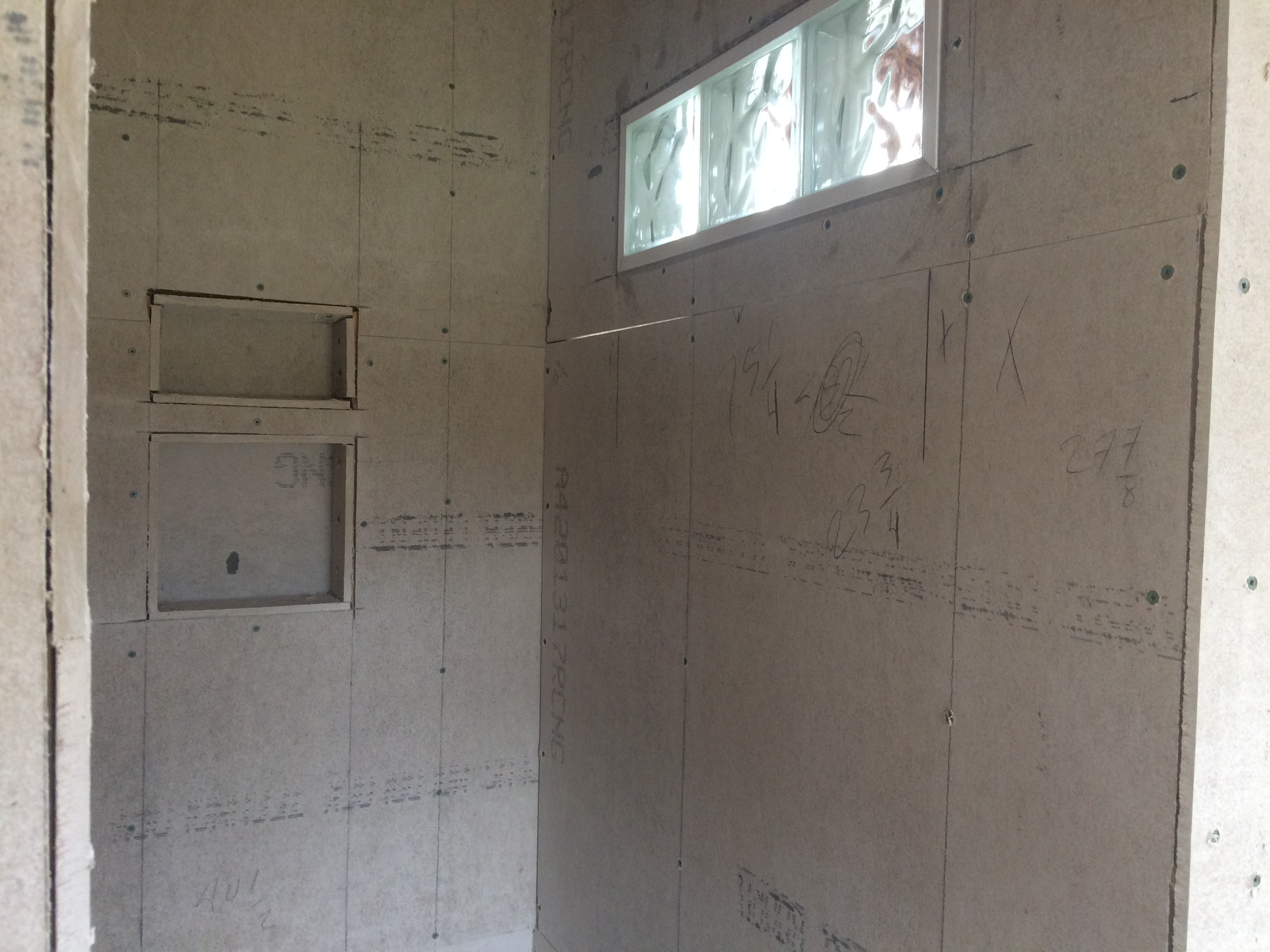

We vacation using AirBnb and VRBO quite a bit and took notes from different places. Quite a few seem to have less than flattering or overly small bathrooms.
While trying to not go too big and take up usable space for the kitchenette or main room, I wanted it comfortable for the in-laws. They are all ex-football players with one playing in the NFL for a few years. If possible, we also wanted room for a king bed.....
Watched quite a few episodes of Tiny House shows for ideas and looked online for some specs/measurements for small bathrooms that still provided for a full size shower and sink. Taking from the Tiny House shows, the bathroom door would be a sliding barn door style. Framing below was for the bathroom. Stained glass window needed moving over so as to not wind up in the way for the wall between bath/kitchenette and I found a glass block window for bathroom on CL for $50. That was framed in prior to the move.

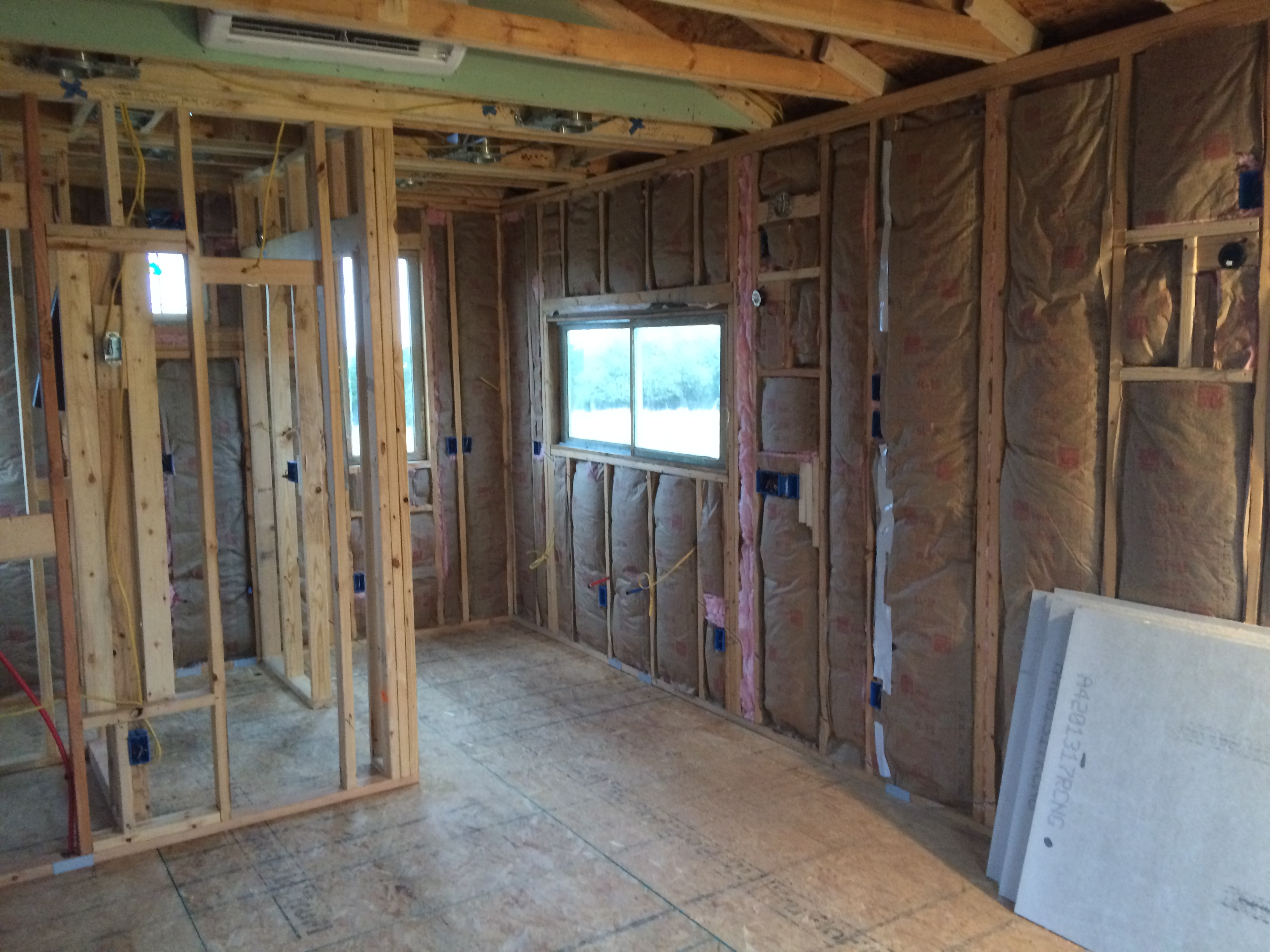

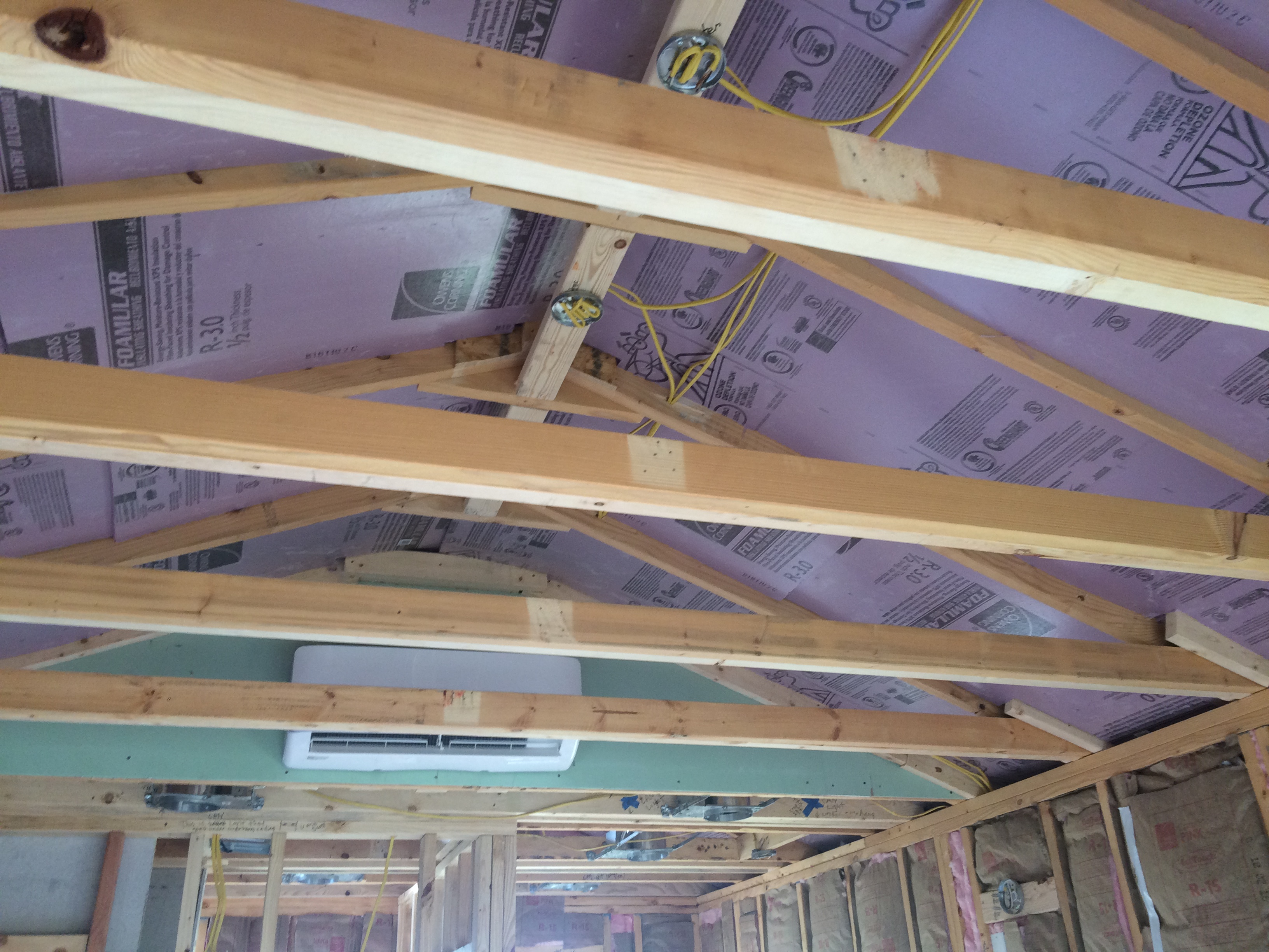

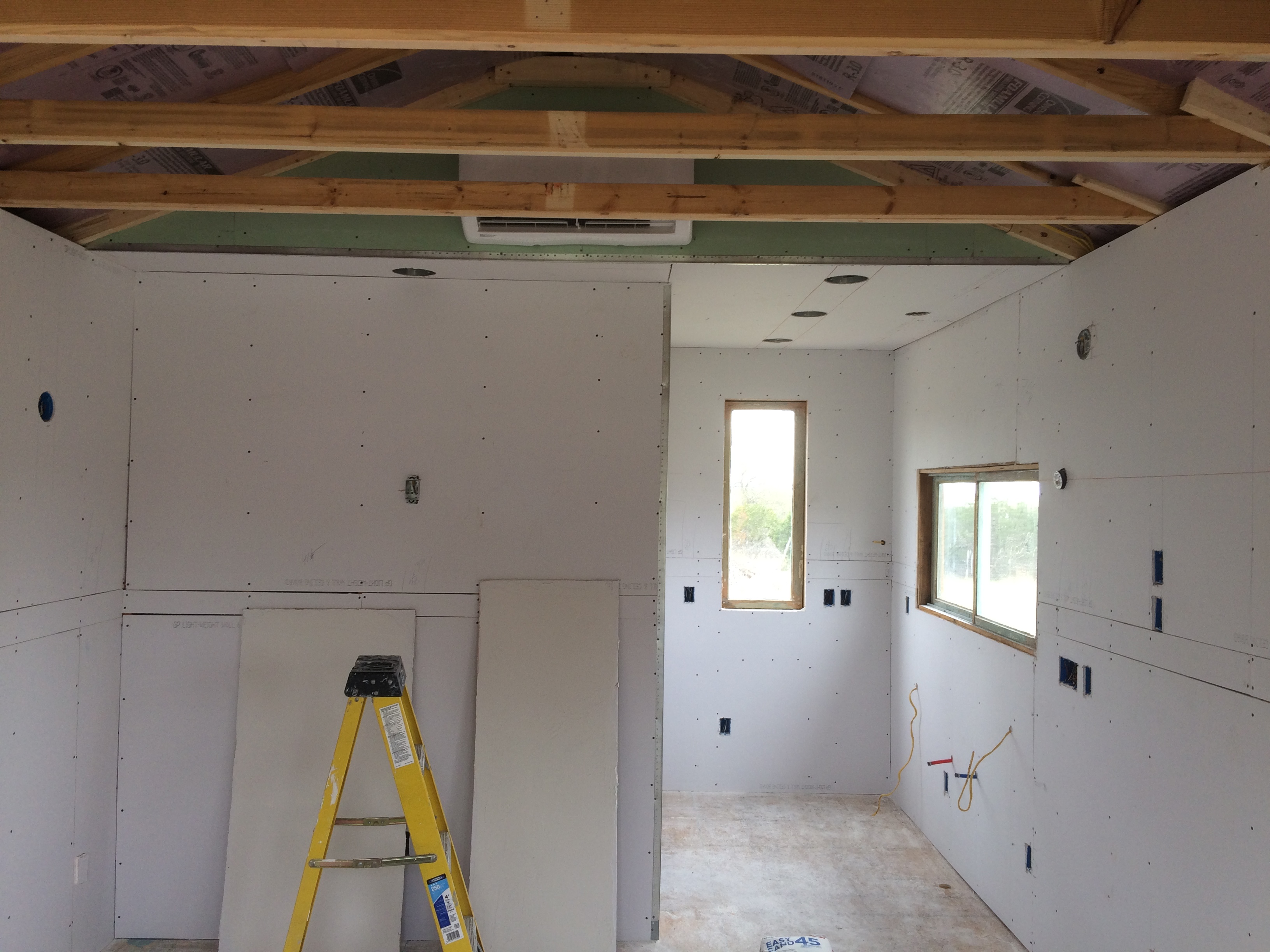

Keeping rustic, we were able to use most of the windows. Only put in one new casement window in the kitchen area.  Someone was throwing out some old double hung windows and those were salvaged and used by turning onto their sides and framed. I wanted to move the green glass bottle window to the shower but dropped it while removing. Wife didn't like that idea anyway, so it worked out. Wiring outlets (with help) and placement of lighting was done so we could get to insulation and then sheet rocking.
