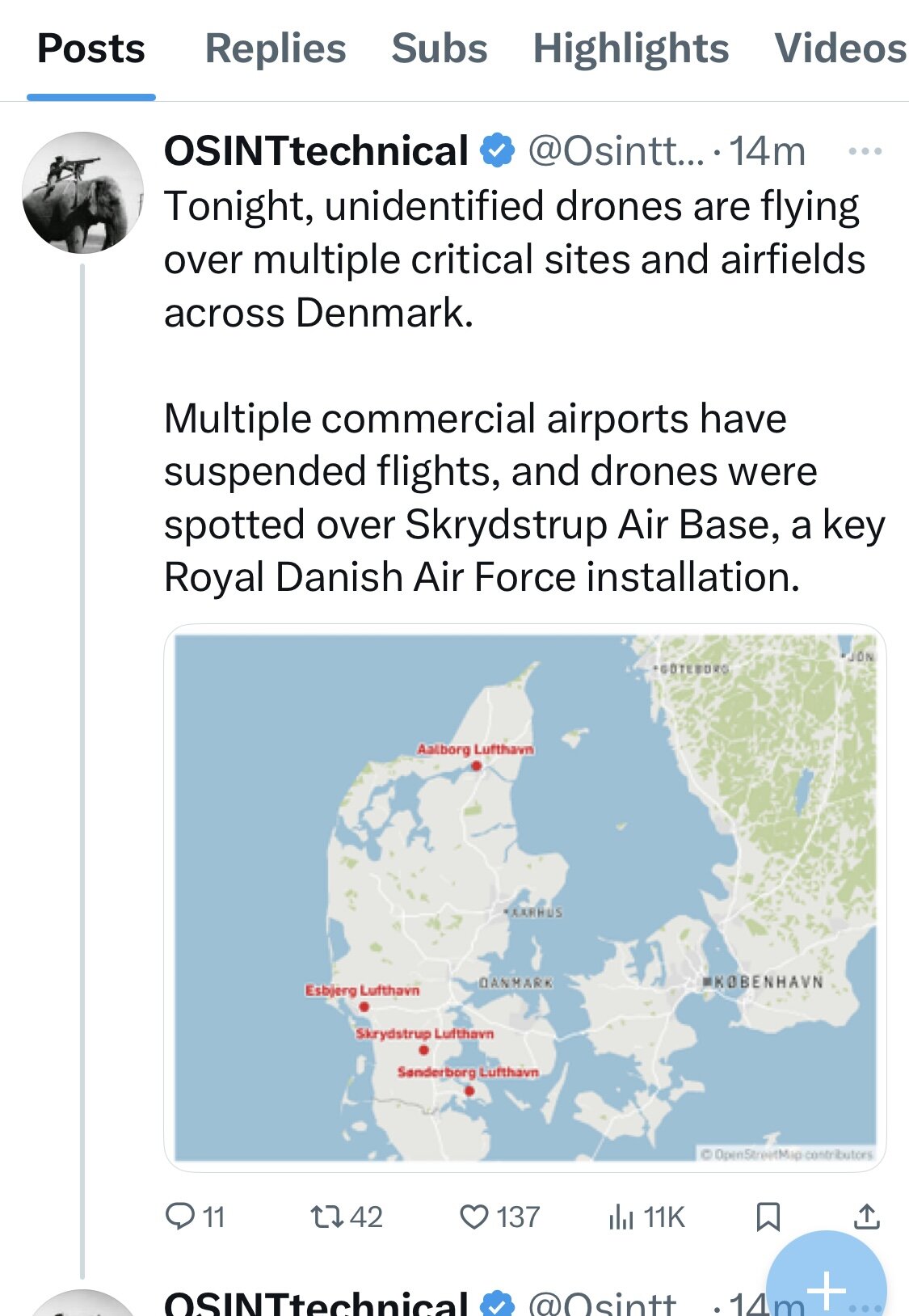

Vlad being salty.  The Nordics and Baltics getting itchy.
He’s trying to scare Trump.  Or tie up NATO air defenses.
Ice Hockey Dancing GIF by NHL
6 minutes ago, Parliament said:
Denmark is a long ways from Russia.  How are the drones getting there?
People are speculating off of ships and the pattern is all over Denmark
