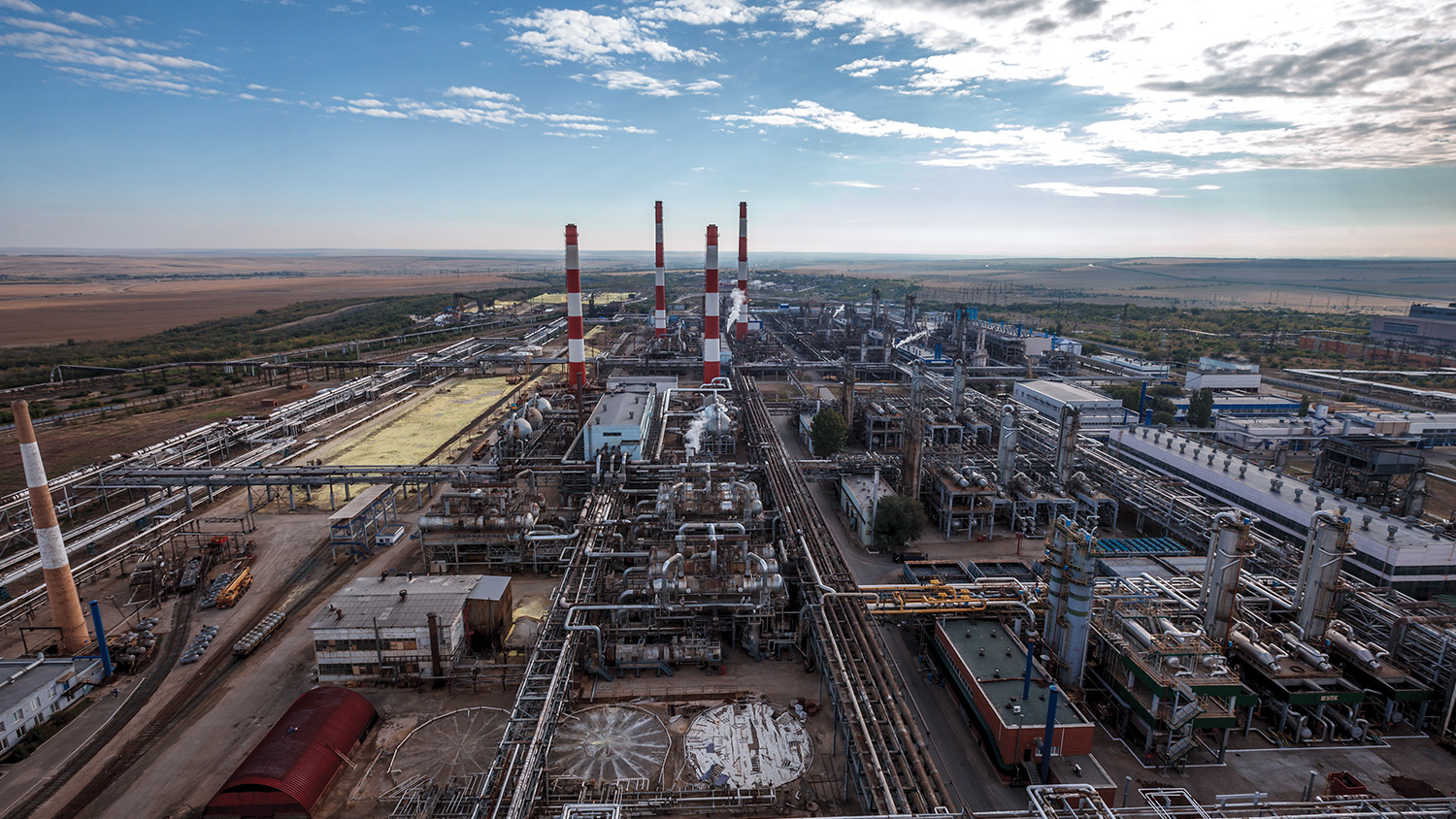

    I volunteered today. Log/Admin role to replace people for 30-60 days. The operation is in the west, or should the Orcs win will be pulled back behind the NATO wall. Either way the humanitarian effort
On 10/15/2025 at 8:55 AM, atomheartbevo said:
1,400 km in.
There are 3 Bashnet Refineries in the Ufa area, Ufa (160,000 BPD), Ufaneftekhim (190,000 BPD, and Novoil (120,000 BPD), with the 3 totaling 470,000 BPD of capacity, and covering over 4,600 acres, or ~ 7 square miles. In Austin, TX, the area between Mopac and I-35, and 38th Street to Town Lake is ~ 3,700 acres.  The total refining capacity here is comparable to Highway 225 in Deer Park, or along I-10 in Lake Charles.
In the screenshot photo in the OP, you can see a lot of green open space within the refineries. That is not common to the few US Refineries I have been to. With so many different pieces of equipment in the refinery, and as spread out as they are, it is very difficult to tell what exactly was hit, but one thing they all have in common is everything  makes big fireballs with thick black smoke.

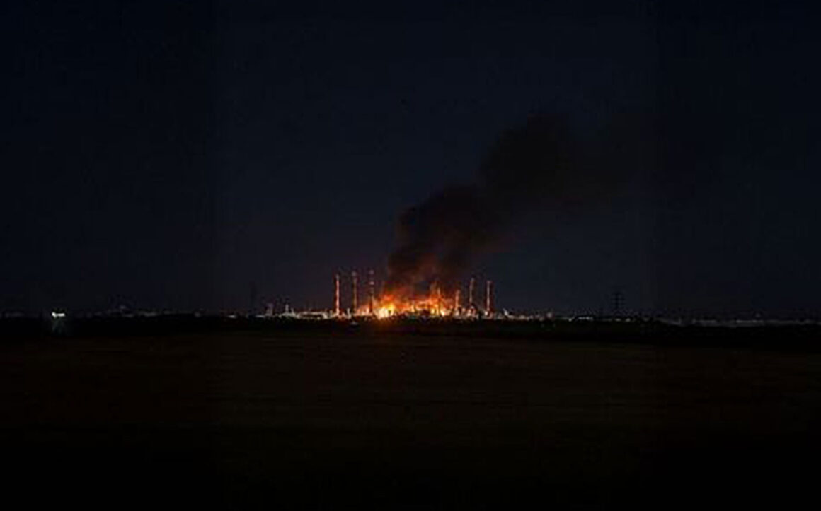

@PTINS don’t know if this a new thing but Ukraine apparently trying to finish off fuel depots and the like hence the second and third strikes.
On 10/15/2025 at 12:14 AM, PTINS said:
My screenshot; Red icons and the Red polygon in the middle are pre October strikes.  The Red icons within the Blue polygon were the Oct 6 strikes. The Blue polygon is from the FIRMS shot in the quoted post. It appears they hit everything on the easy side of the terminal, including the rail loading/unloading facilities.
I believe Ukraine has chosen not to target the 3 large tanks on the west side of the property, because they are large, and very close to civilian infrastructure adjacent to the terminal.
Should have called me. I put out a diesel fire, at fire school, in a 6'x6' pan ~ 6 " deep, with a dry powder extinguisher.
The protocol w/ oil & gas fires, cut off the fuel source, control the fire, and then assess. your options. Burning gas (vapor, natural gas, not gasoline) in a controlled environment is preferable to a large gas plume continuing to vent and grow, looking for an ignition source, that vaporizes everything within the plume. Most big gas fires, like the one next to Walmart in Pasadena, you isolate the fire and let it burn itself out.
Most liquid fires, try to put out the fire, and clean up the mess.
From the FIRMS data, it appears that most of the facility is burning, which probably includes the fire water system, is compromised and/or to hot to get access to.

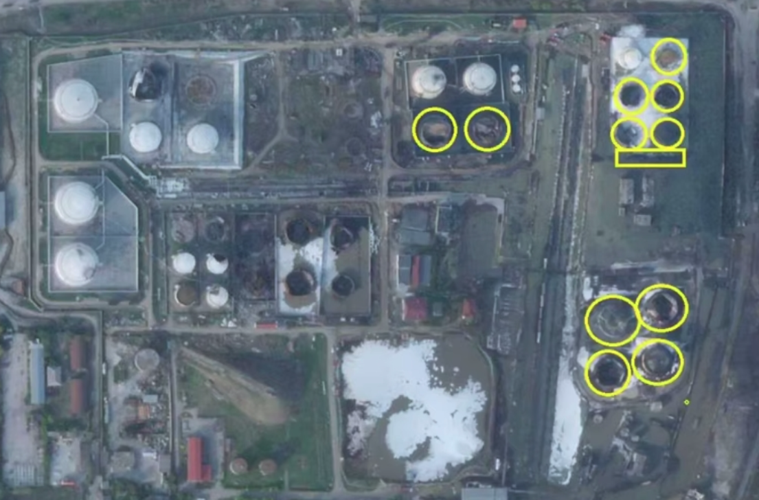

Updated photo of Feodosia Terminal, Crimea
Orange - Attacks prior to August 2025
Red - Attacks last week (early October)
Blue - Attacks this week
Satellite Photo
I think Ukraine is dragging their 'nads showing their capabilities of the systematic destruction of Russian infrastructure.
"Satellite images confirm 11 fuel tanks destroyed at Crimean oil terminal after Ukrainian strikes
A key fuel supply hub for Russian forces in Crimea has lost 11 storage tanks to Ukrainian strikes this month, with several more tanks unlikely to be restored to operation.
by Maria Tril, 18/10/2025
Radio Liberty's Russian service has released satellite imagery documenting extensive damage to the oil depot in Feodosia, occupied Crimea, following Ukrainian strikes on the facility.
Ukraine's drone strikes focus on Russian military airbases, manufacturing facilities, oil refineries, and energy infrastructure. According to military analysts, these operations aim to disrupt Russia's fuel supplies and inflict economic pressure. Attacks on oil refineries have hit approximately 38-40% of Russia's refining capacity, damaging production of gasoline, diesel, and aviation fuel, which has led to shortages and price increases within Russia.
The images show 11 fuel storage tanks completely destroyed as a result of Ukrainian attacks on the site, according to Radio Liberty. Several other damaged tanks are unlikely to be recoverable.
Ukrainian forces struck the Marine Oil Terminal facilities in Feodosia on 6 October. The General Staff of the Armed Forces of Ukraine described it as "a multifunctional technological complex for transshipment of oil and petroleum products from railway tank cars to sea vessels and back, as well as to road transport, which is involved in supplying the occupying army of the Russian Federation."
The massive fire that erupted following the Ukrainian strike could not be extinguished for more than two days, Radio Liberty reports.
On 13 October, Ukrainian military forces struck the Feodosia oil depot again.
The result of two Ukrainian strikes on 7 October and 13 – 11 completely destroyed fuel tanks, several damaged and unlikely to be recoverable, according to the reports.
The first Ukrainian strike on the oil terminal in October 2024 destroyed or fatally damaged 14 tanks at the hub that supplied fuel and lubricants to the Russian army in occupied Crimea. A Pantsir air defense system installed at the refinery in 2022 failed to prevent any of the three Ukrainian attacks."

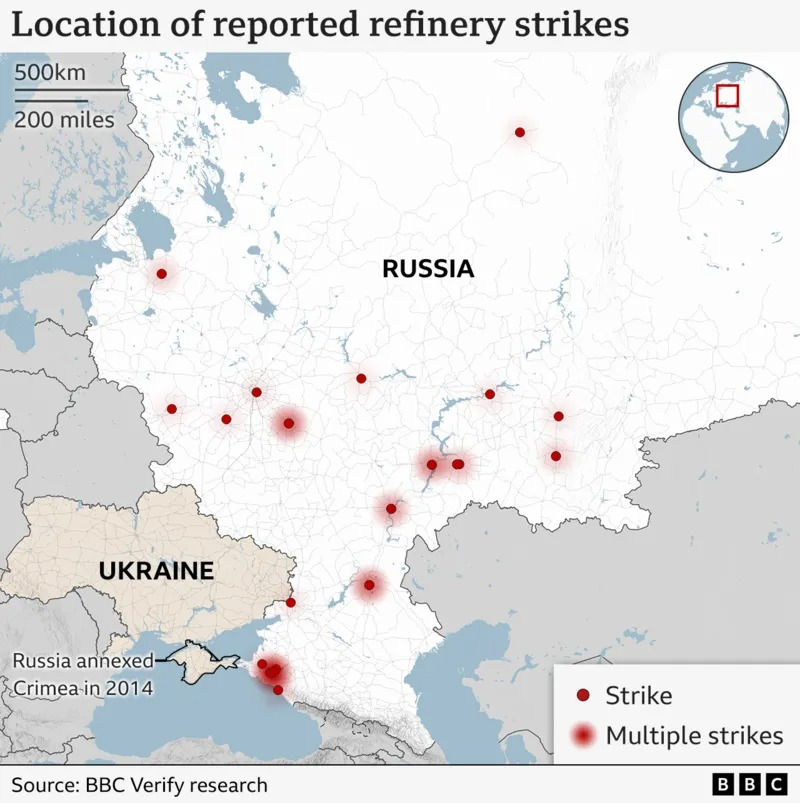

BBC verify counts 21 russian oil refineries hit since — already 48% more than all 2024
A record 14 refineries were hit in Russia in August and another 8 in September, sparking fuel shortages in many Russian regions.
Map showing reported Ukrainian drone strikes on Russian oil refineries across the country, including multiple hits on major facilities.

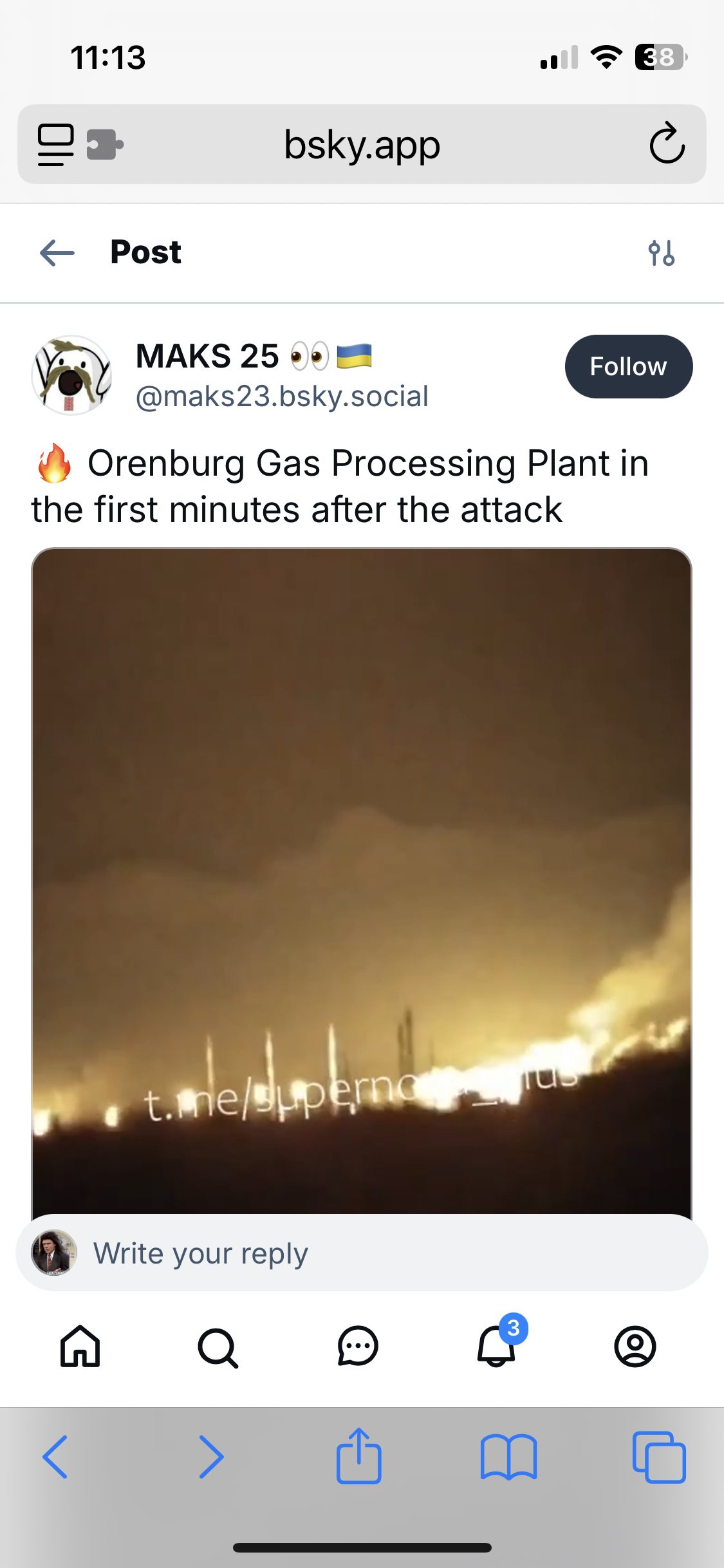

Has Russia just given up about “drone debris”causing these issues?
https://www.reuters.com/world/europe/ukrainian-drones-cause-fire-russian-gas-plant-governor-says-2025-10-19/
Orenburg gas processing plant, the largest facility of its kind in the world, has been forced to suspend its intake of gas from Kazakhstan after a Ukrainian drone attack, Kazakhstan's energy ministry said on Sunday.
Orenburg regional governor Yevgeny Solntsev had said earlier on Sunday that the plant had been partially damaged and that the drone strike had caused a fire to break out at a workshop at the plant. The fire was later put out, Russian media outlet Kommersant reported, citing the operator.
The facility, operated by Gazprom, has an annual processing capacity of 45 billion cubic metres and handles gas condensate from both the Orenburg oil and gas field and Kazakhstan’s Karachaganak field.
Kazakhstan's energy ministry said Gazprom (GAZP.MM), opens new tab had notified it of the emergency but had yet to provide details on the extent of the damage or a timeline for resuming full operations
It's now a "fire at a workshop" and never "damaged a single-point-of-failure processing tower thing that the whole refinery relies on and if it goes out of commission the refinery is shut down".

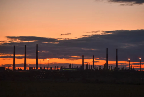

But, having spent my professional career working in and around gas processing plants, where the marvels of technology showcase the simplicity of Newtonian physics, where everything around you is a hazard and safety is preached every day, all day, until it becomes your way of life, it is with mixed emotions that I share my thoughts here.  The people that work here don't carry guns, they carry pictures of their kids.
"Russia says overnight Ukrainian drone attack targets gas facility in Orenburg region Governor says fire broke out at a workshop of partially damaged facility, adds no casualties reported" - Burc Eruygur  19.10.2025
Nor was it a just a "workshop fire."  I can't even write that without laughing out loud!!!
 You all have been very patient with me as I drone on (you like that ?) about hitting specific targets rather than simply lobbing grenades over the fence. A gas plant has nothing but large pressure vessels full of high pressure natural gas and Natural Gas Liquids.
And massive gas plants with a series of "trains" of multiple process vessels, heat exchangers, pumps and compressors, and separators and condensers, ...
My screenshot of the Orenberg Gas Plant.
I have highlighted in red the tall Red & White striped smokestacks you see in the photos and the video in the OP. The video is shot from the road to the south, ~ 3/4 mile from where the actual fire is. I have highlighted what I call "Process Towers" in yellow, which is where most of the intense fire is, between the smokestacks. It would appear that massive fireball envelopes most of the process towers.
The roar of the fire in the video is the expansion of high pressure gas at sonic velocity, depressuring rapidly from 1,000 PSI to atmospheric pressure, and to make it really exciting, igniting and burning. The heat from a truck fire will melt everything but the wheels and the drive shaft.  This fire, with a constant fuel source, won't leave much of anything.
Just for fun, crank the sound on the video of the fire up to 10, 11 if you have it. This is from a cell phone 3/4's of a mile from the fire.
The Orenburg Gas Plant is one of the largest in the world, 2nd to the massive Empress Plant in Alberta, CA, (maybe something in Qatar?). This plant is 4 times larger than anything in the Lower 48 of the US, processing gas from the Orenburg region of Russia, as well as gas produced from the Karachaganak oil and gas fields in neighboring Kazakhstan.
The gas processed at the plant is the two extremes of natural gas; (i) Gas with any helium content is very valuable (used to be ~100x the price of natural gas) and usually becomes government property and has a processing plant built just to extract the helium, and (ii) the other side of the equation, gas with extremely high concentrations of hydrogen sulfide (H2S), mercaptan sulfur and carbon dioxide (CO2), "acid gases", which are lethal after 1 breath at these levels. The commercial spec on natural gas pipelines is 4 parts per million (ppm); some of this gas has 6.8 % H2S, 68,000 ppm.
This is a case where you isolate the fuel source, and let the fire burn itself out. Even then, the products of combustion include sulfuric acid and carbon acid, among other things. You always want to be upwind of these plants.

 Some Gas Plant porn:
The 7 "smokestacks" are easily identifiable, and the multiple flares can be seen, where the "off gases" are burned in a controlled manner.
In the photo below, as you look at the smokestacks, the various process towers can be see in the foreground and to the right.  Gas processing towers are not as big and tall as refinery towers, as more of them operate at higher pressures, up to 1,000 PSI, and some of them operate at temperatures as low as - 170 °F.  The roadway in the OP video would be to the right in this picture, with most everything in front of the 4 smokestacks within the fireball.
 Nice shot of a mushroom cloud against the backdrop of a much larger fire, probably a smaller pressure vessel having a "BLEVE", a Boiling Liquid Expanding Vapor Explosion.
It occurs when a container holding a pressurized liquid, like propane or other industrial gases, is heated to a point where the internal pressure becomes too great for the vessel to withstand (the boiling liquid vaporizes at a higher rate than the capacity of the relief valve). This causes the container to rupture, and the liquid flashes into a large vapor cloud, resulting in a powerful explosion and, if the contents are flammable, a massive fireball.
