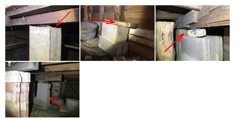

Slab foundations didn't really become popular until after the war, so I doubt it's a slab.
One thing you kind of have to watch for with older houses, particularly in more rural areas, is that the piers are actually drilled and sunk piers, rather than piles of rocks or even tree stumps, or concrete blocks sitting on the ground.  It's still more easily repaired than a slab most of the time, plus the plumbing and wiring benefits.  But if one of those "piers" moves, it could make a mess as regards drywall/plaster
The house I referred to was sitting on a variety of ad hoc "piers" when I bought it.  Cedar stumps were apparently the go-to solution.  I had it in my mind that I might want to add a 2nd story down the road, so I had all new piers sunk and poured.  The footprint of that house was probably 1300 sf and the cost was ~ $10K.  Made all the difference in the world -- that house hardly shifted at all, even with extreme wet/dry swings common to our area.

So this is not what a pier and beam foundation is supposed to look like?
Not yer better ones, no.
JFC, beyond my wildest imagination.
That's not what they're SUPPOSED to look like, but it's what a lot of them DO look like.
