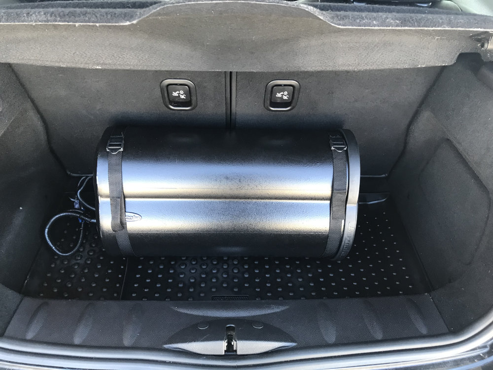

I'm gonna bump this thread since it's car audio related.  I bought a mini with the base audio system so I wanted a little bass upgrade but nothing special.  After some internet research I landed on buying a Bazooka tube for simplicity and quick removal.  I found one at sonic that was open box for $230.  It was the BTA10250D which is a 10" with a 250watt class D amp.
When I arrived home on Sunday there was not one but 2 boxes blocking my front door.
WTF have I done.  Both boxes were 30x18x16 and the mini's trunk is only about the size of a large gym bag. I wanted to add a little something but even with the gain all the way down the damn thing overpowers the other six speakers significantly.  Hopefully tomorrow I'll be able to adjust the LOC levels but if anyone has any other suggestions I'm all ears.
BTW what should I do with the second one they sent?  Should I send it back?
Why not a low air 8in in a truck box (they make shallow throw woofers). Think like fits behind a bench seat in single cab truck. It weighs ten pounds and removal is disconnecting the speaker wire from a quick release. Use Velcro instead of screws for easier removal
For a visual
Thx for the suggestion @ChickenSandwich but unfortunately hindsight is 2020.  I went with the bazooka tube because back in the 90's early 00's when I was working in car audio they were an easy answer for people who wanted want just a little extra.  I always wanted a lot extra back then as I went from 3 10's (JL 10w6's), to 4 12's (JL 12v4's), back to 2 12 (Rockford Fosgate P3's).  Since then I've always bought BMW's with the upgraded HK or Enhanced Premium and at my old age it's perfect.
I was able to play with the Iine out converter gain today and it may be my problem.  The level is either very low, essentially off, or full blast.  I may try to replace it or bypass the low level outputs (I'd only be using the LOC for the audio sensing remote out) if I can't get it dialed in (Bazooka actually recommends high level inputs).
I'm still deciding if I want to be honest and sent the second tube that was sent by mistake back.
Got it in though.

bumping this thread. got a nice xmas bonus, so finally gonna pull the trigger on an upgraded system. Will post chosen specs when I'm finished choosing components, but wanted to see if anyone had any updated recommendations for installation places in Austin.
