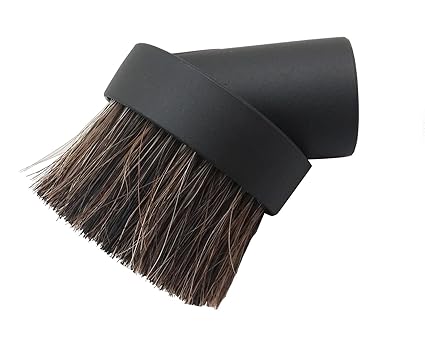

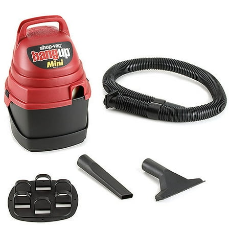

Small shopvac to lug inside the vehicle (or a really long hose) with a horsehair brush (prevents scratching) attachment:
